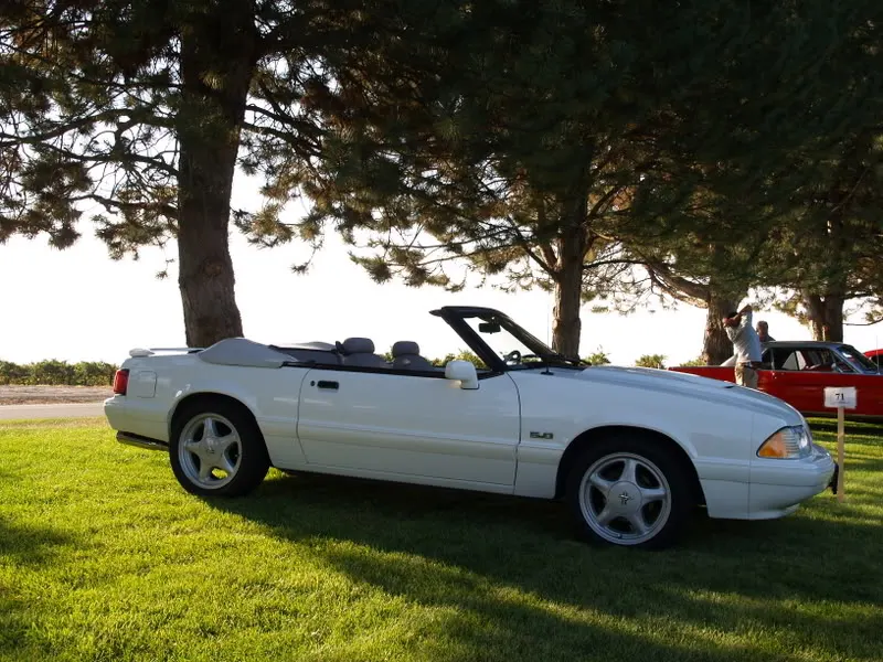

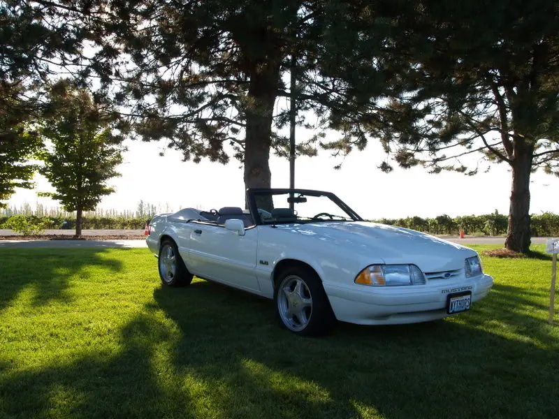

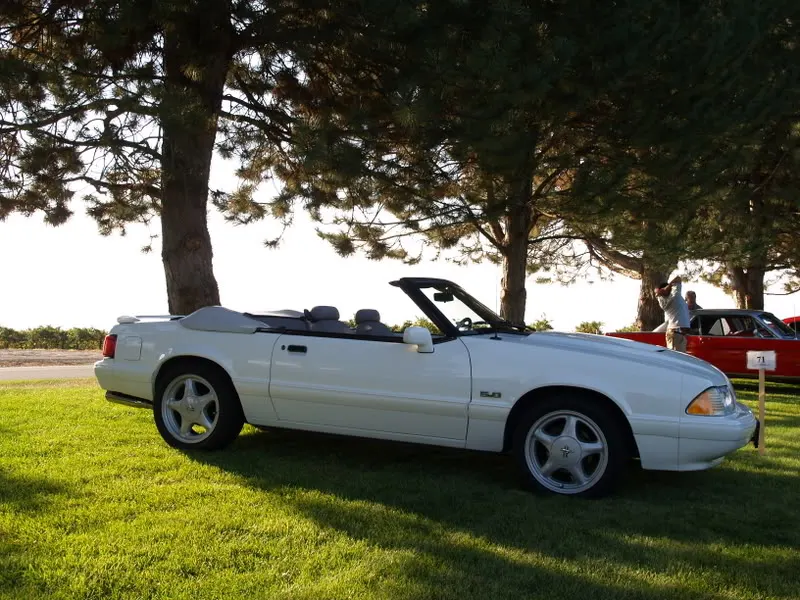

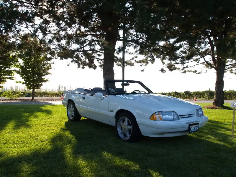

Okay, as promised, here are a couple of exterior shots.
You can't really see the vents from this angle:
Profile shot:

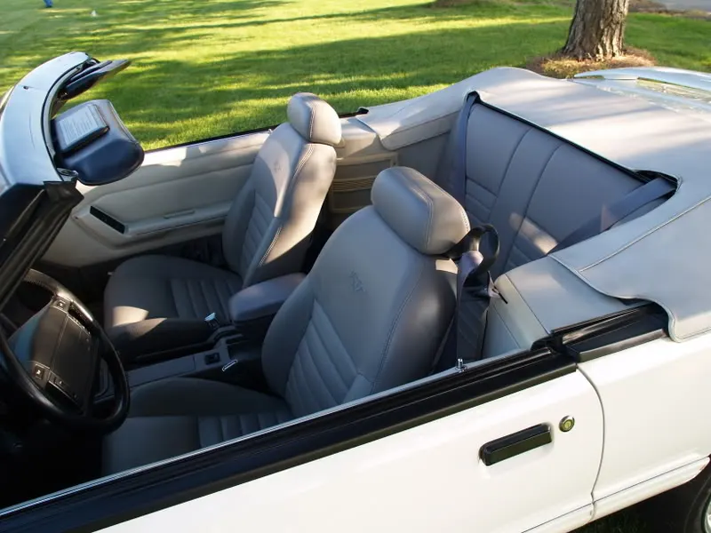

And just because I haven't whored up my 03 interior as of yet:
Hey Wythors... Did you use the entire seat setup from the 03, or did you have to make some modifications from the original seats. (seat tracks) I have read that the newer seats sit higher, but from what I can tell, those seats look like they were made to be in there.
I just can't get over how nice that looks...
Thanks for posting those pic's
The front seats are a direct bolt in with no modifications needed to the tracks at all. You do need to do a little custom wiring to make the electrical connections. One of our fine members has a very good pictures of the needed wiring. A quick search will find it with no problem since it's been posted here and the Corral often. The seats do sit noticeably higher, but it's nothing to be concerned about, especially in a convertible and the improvment in comfort is well worth the slight increase in height. I would guess that it's less than two inches. The rear was custom done to match the fronts.

did you recover your backseat with the 03 skins or did you trim the foam to fit your car? I have the seats from a 98 in my vert and I ended up recovering my old cushions in the rear with the new covers. my camera ate the big one or I'd post pics.
