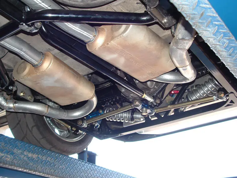

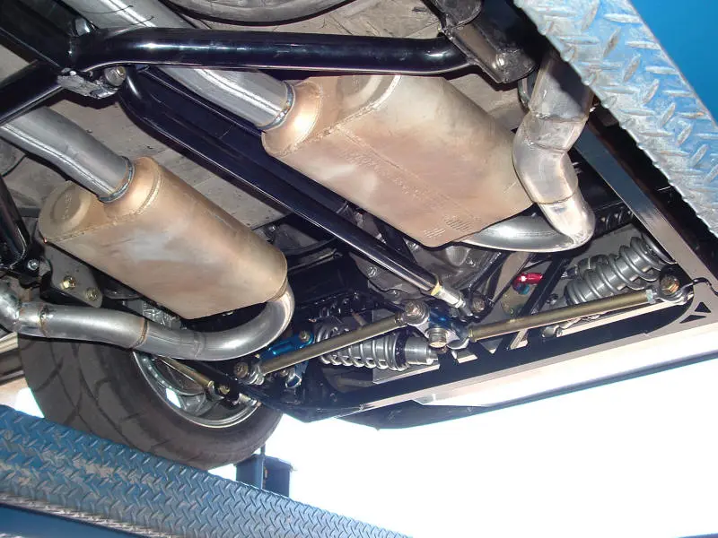

I have one on my 70 Mustang. I put it on after I took of the GW leafs and watts system which was a good system to begin with. I like it better than what it had before and it articulates the road better than before. Not a major improvement but definitely noticeable. My version is the older version no longer being sold by TCP. They are in the process of revising it.

Just finished the install. It's an incredible system and a major improvement. The car turns much easier and does not have the tendency toward over steer. Made a wheel hop problem I had disappear! This is the new version!

You guys never cease to amaze me! Some great looking cars ... with some incredible modifications. Jag IRS ... who would have thought it - William Lyons would be turning in his grave ...
