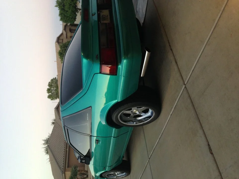

Well turn out a few weeks ago I heard a strange rattling sound coming from under my car drivers side and I was hoping it was not what I originally anticipated it to be!! 1993 Mustang LX with BBK Hi Flow Cats, anyways I had to take my 5.0 to my mechanic so he could replace my balancer so while I was there I had him listen to rattling and he said same thing coming from cats.
