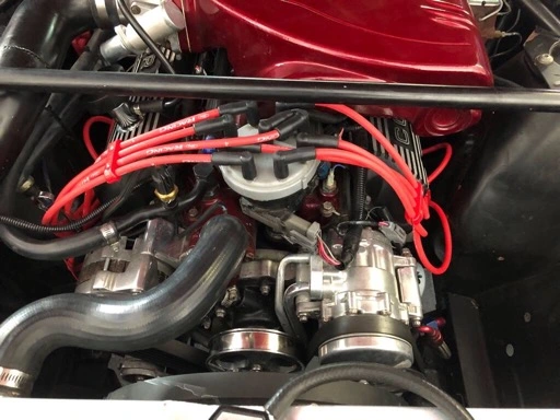

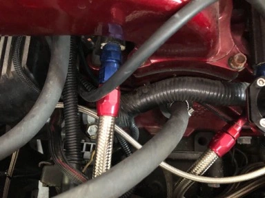

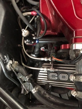

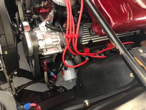

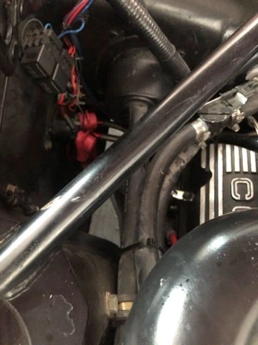

Based on these pictures, can anyone point out where my salt and pepper shakers might be located (and thermactor and O2 harness). Bought this car modded as is, previous owner passed away.

Not from those photos.
The "salt-and-pepper shakers" are the two plugs from the injector harness. Find thw wiring to any fuel injector and follow it back to the rear of the intake. There were two connectors back there that are white and black. Sometimes there is an extension harness
A new trend (since this is a 14 year old thread) is to delete them and use a modern plug, or splice them direct. Hard to see in your pics.
Also, O2 sensor harness is located pass side fender under where the MAF is located. Thermactor solenoids are on the pass side rear fender apron area.

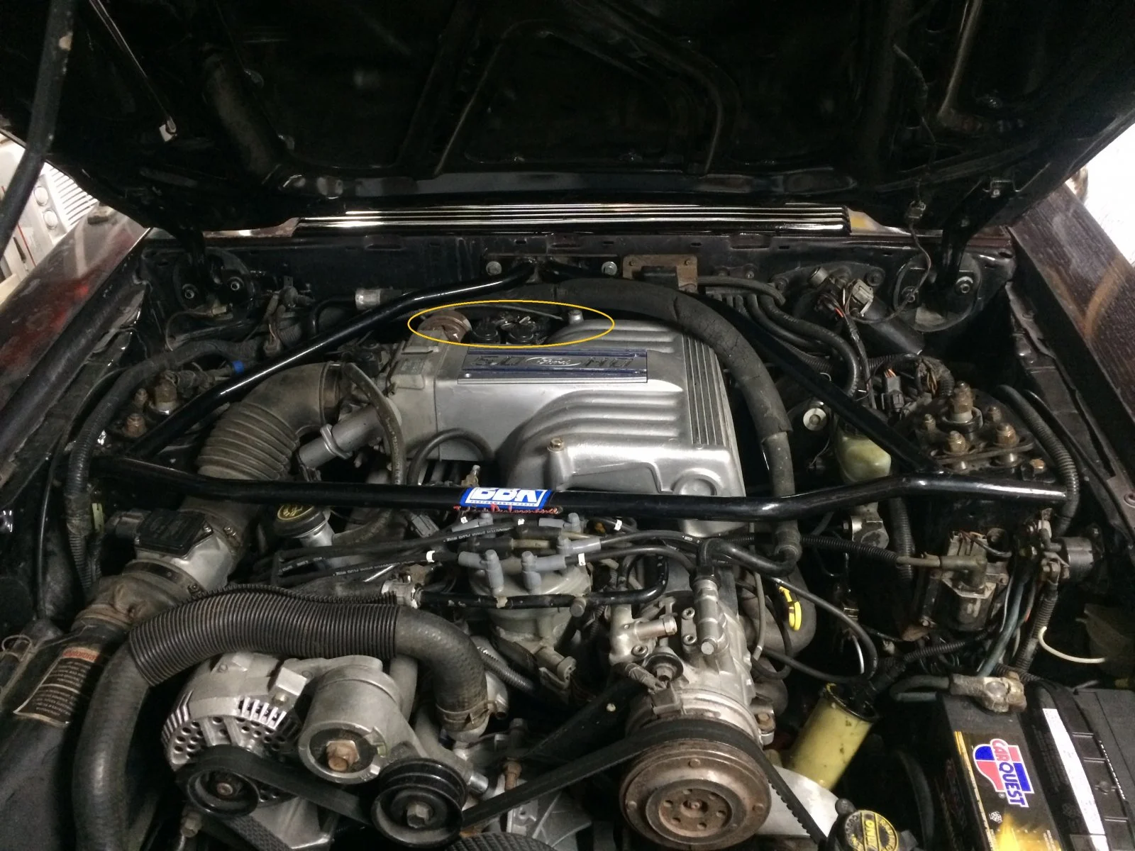

Circled in yellow is where they are normally located.
CUAviator - looks like someone has a custom harness or someone eliminated the connectors, likely cutting and splicing the wires together directly.

Yeah, that’s kind of what I’m gathering at this point. I’ve looked all over this engine bay based on diagrams people have posted. I was just hoping maybe someone had a setup similar and could point some stuff out.

Normally that’s correct. But we’re you able to identify them as such in my engine bay?
As for the S&P shakers, I’ll keep looking. But I don’t think I have them. Gone the way of the EGR.
If your car still has the stock intake on it, these connectors are hung on a plastic clip that is attached to the portion of the intake behind the throttle body, facing the firewall.
