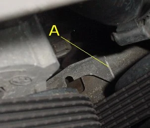

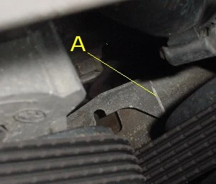

Here's a pic of the timing mark .... there may not actually be a mark there .... but there is a "point" to the metal. You'll know what I'm talking about when you look in there.

You scribe the one you want on the harmonic balancer.
The upper timing mark (which is between the water pump & tensioner pulley, I believe) does not need to be scribed. You can if you want, though. The metal comes to a "point" there (pic does not show it fully) and you just use that point.
The thing i wound up doing to see the numbers better since i could not see them at all is that i got the white out pen thing and crawled under the car and filled in the dashes and the numbers so it was easier to see with the timing light and they light up a hell of a lot better.
yeah...when i first did it i was looking at the wrong marker....When i did mine i stood on the passenger side of the car and tried to get a decent angle...it tends to be a bitch to actually see the marker you need...just remember that it is more to the top of the harmonic balancer rather then the left side which was the one i was looking at....if i remember tomorrow ill take a picture or sometime tomorrow send me a pm to remind me.
