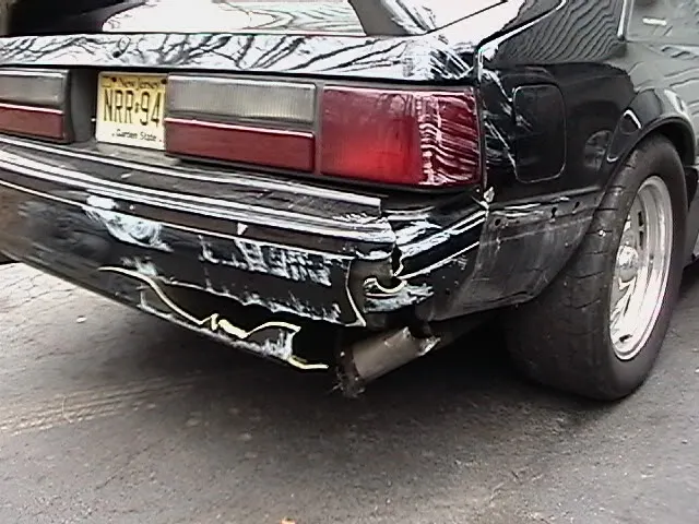

you're going to be searching for another car when you autostart that sucka and it takes off in gear. a buddy installed one on his car and his gf drove it to the store one night left it in gear after she came back. next morning he started that the car from his window, turned around, and next thing he heard was BOOM! right into his neighbors pickup. it's just a matter of time. also heard a story that someone sold thier car and forgot to mention to the new buyer about the remote start. buyer took car home, left in gear & parked, turned around to turn alarm on, didn't know about the remote start. my guess is he was fiddling with the remote and sure enough... car took of on him and crashed down the road. :nonono:
Yea, that would be me actually, haha. I learned my lesson with that one. I have mine wired through the NSS on my trans now. Won't start in any gear now.
Here's what happened:
