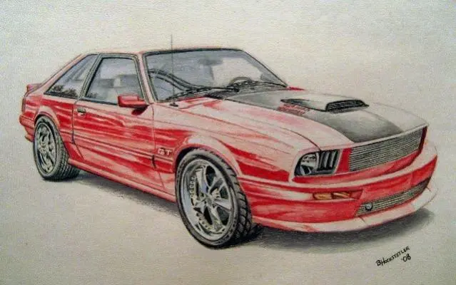

I... wanna... See some pics!!! That sounds like such a cool idea!!! :D
Off topic in a way, but this is friggin' cool!
:eek:
