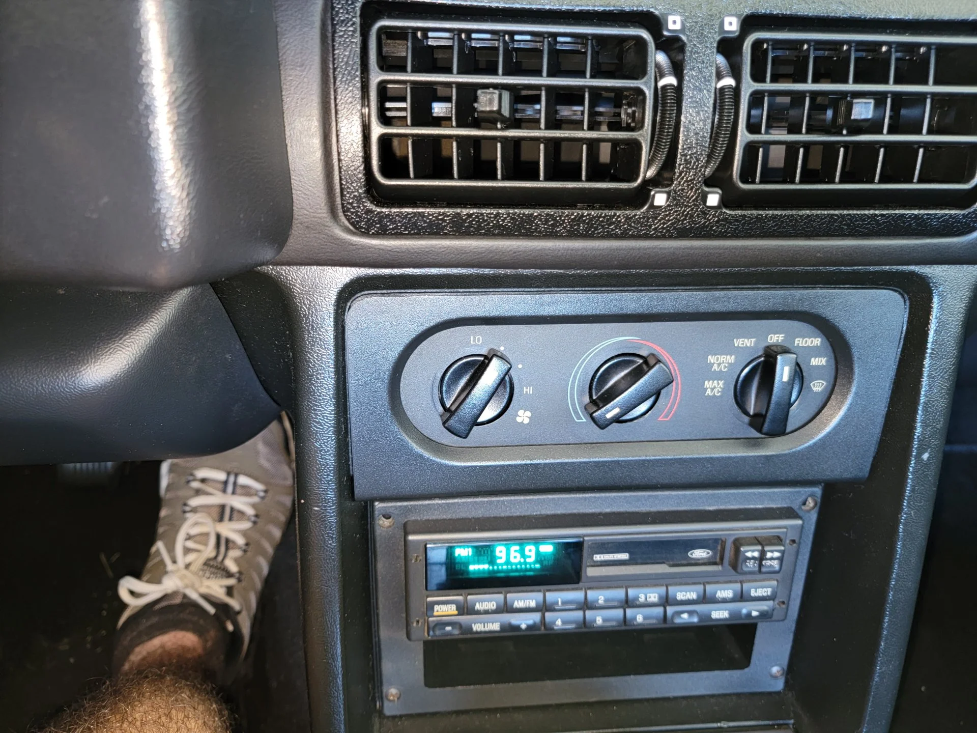

According to Mike and the YouTube guy-it likely isn’t what you’re looking for-but here’s pics anyways lol-

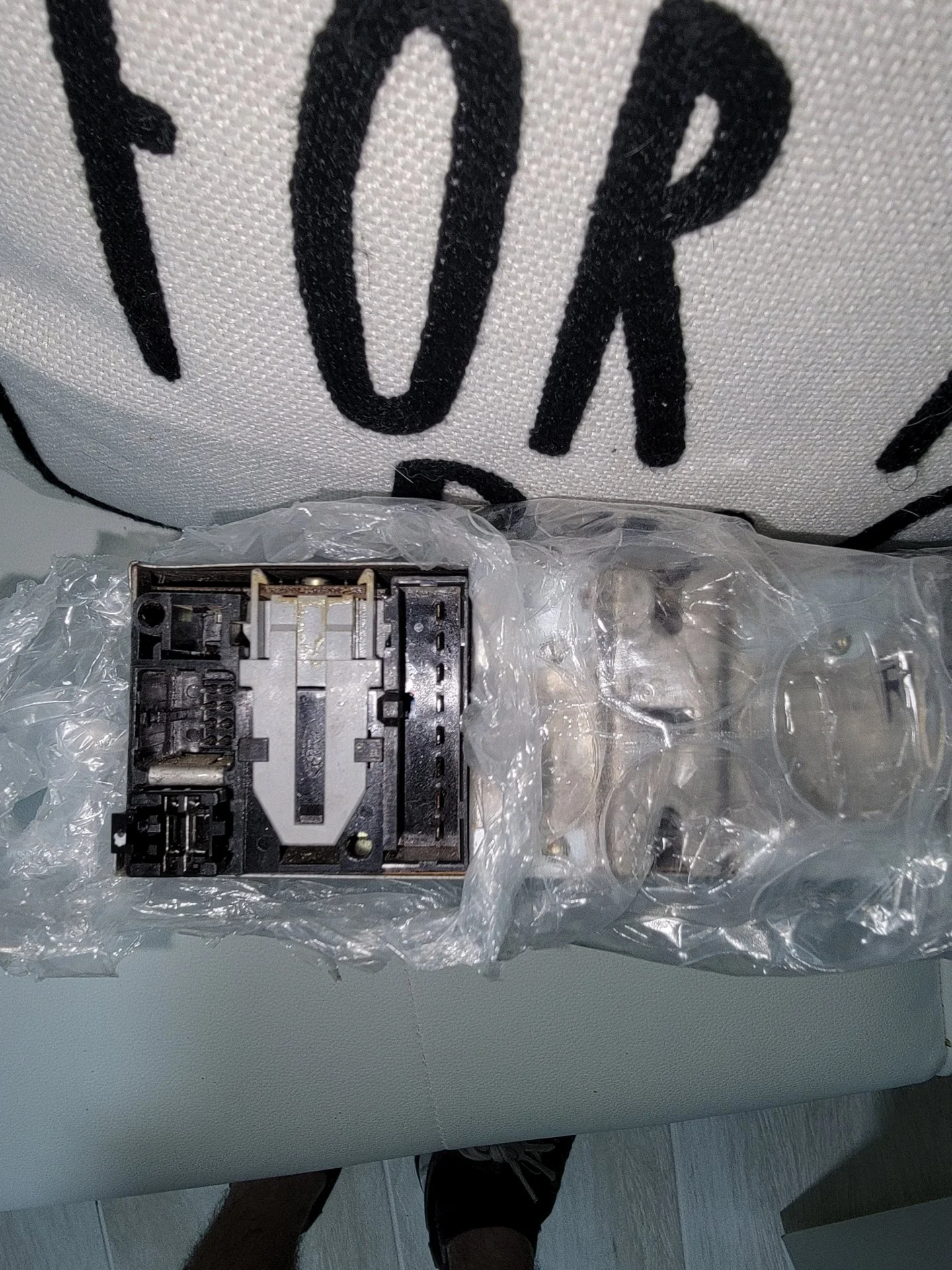

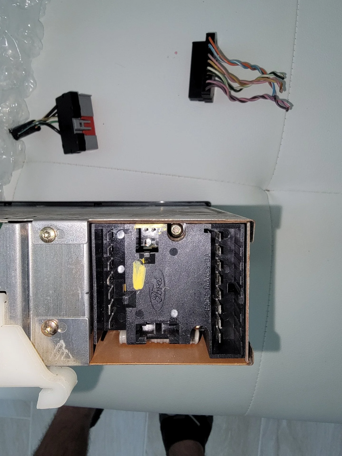

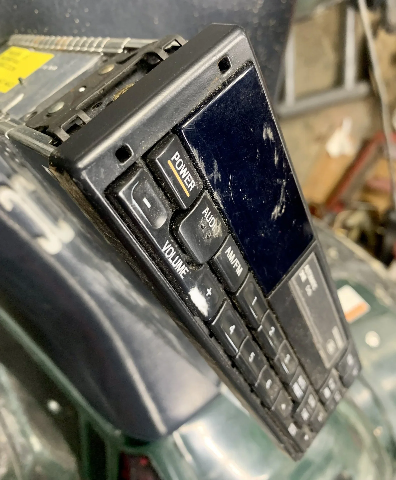

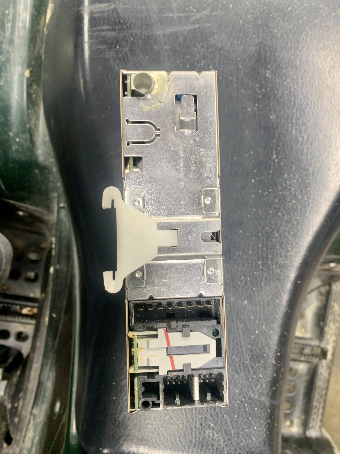

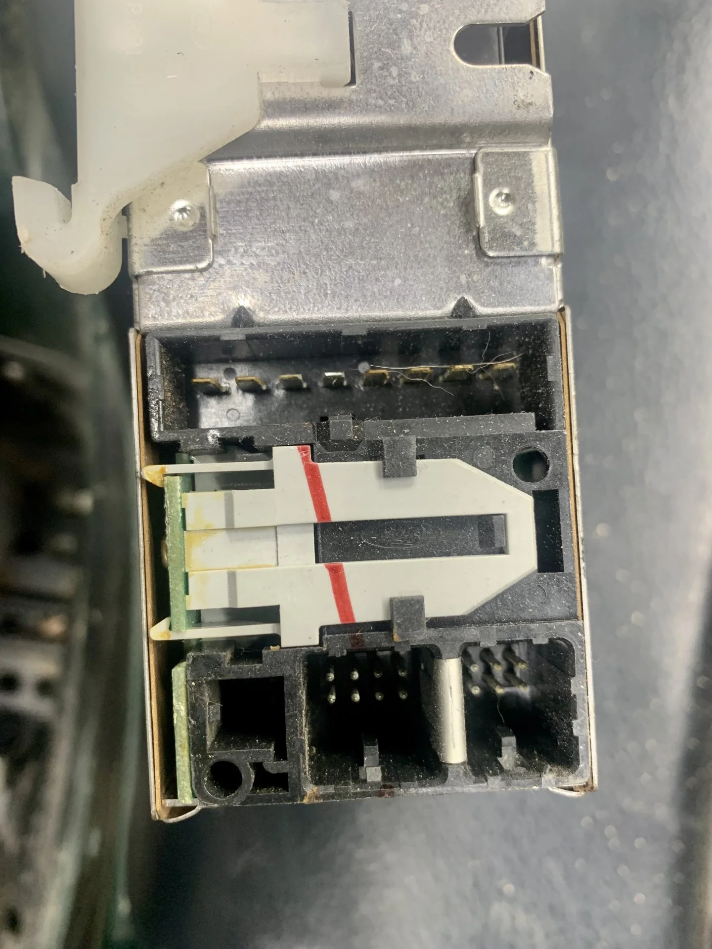

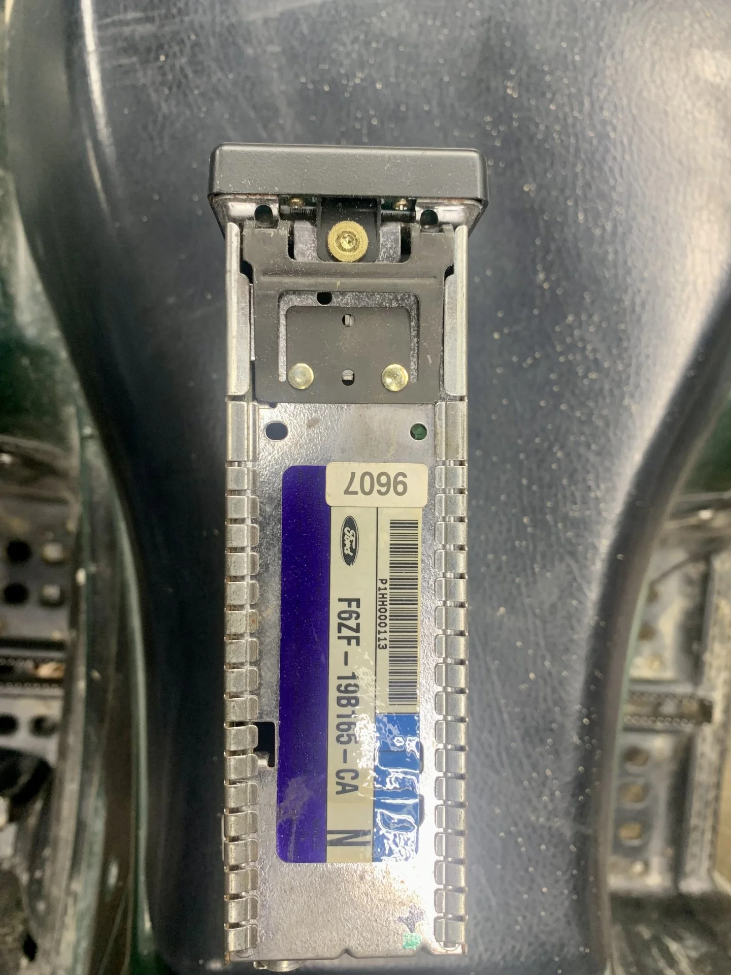

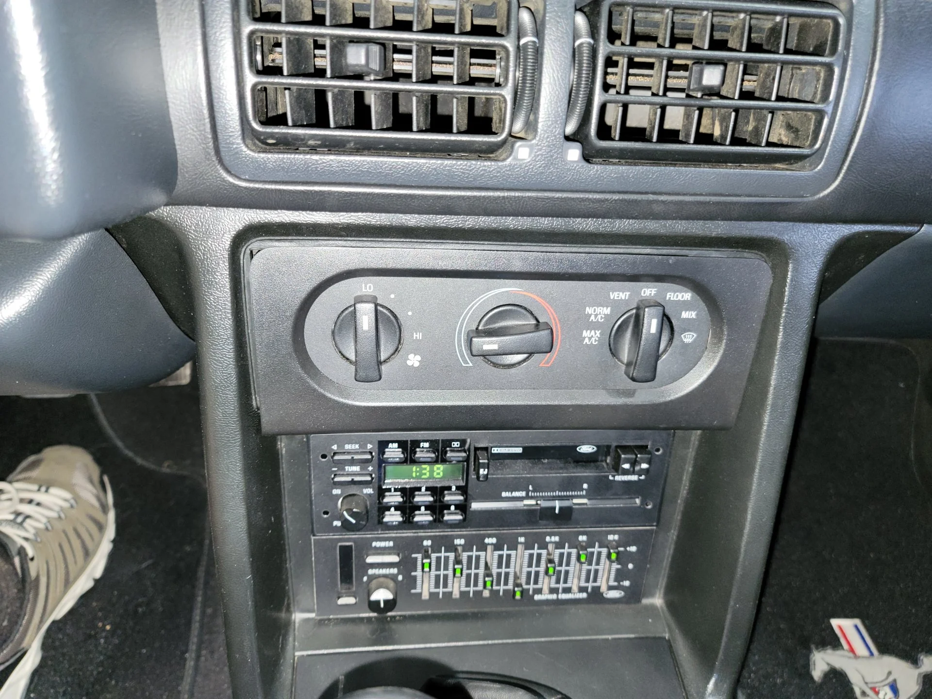

You are correct Ragged GT I have a list of pictures for radios from 87 to 93, 93 is its own Beast because you have the blue cable similar to USB that you have to have with the factory amp unless you bypass the amp and go with an aftermarket radio. Also they made two types of radios that are similar for the front face but the back is different. I have several pics that I'll attach with this I've owned every mustang year 88 to 93 except 87 but 87 had the same radio. If you notice two of the pictures in the back one has different clips for inserting the wire harness. 92 had the radio with the EQ which was one year only and 93 was different which is the same as Ragged GTs pics. I do remember you have to put a clip insert in the back and that's for interference with the amp I have a picture of that as well.

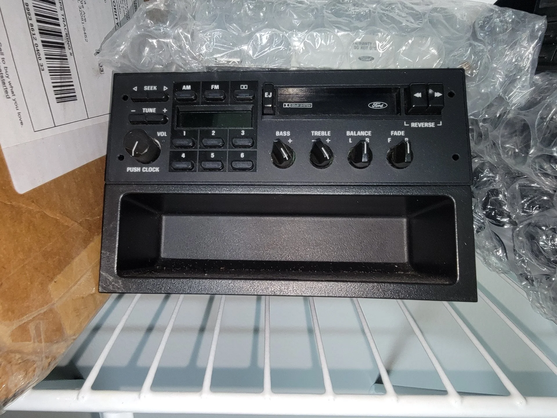

So you could turn it into the right radio. But it would take parts i assume he doesn’t have. Mainly the squared off faceplate and the bottom tray.
If he managed to find a busted out 93 radio, he would then have all the correct parts and just needs to find a donor radio like yours.

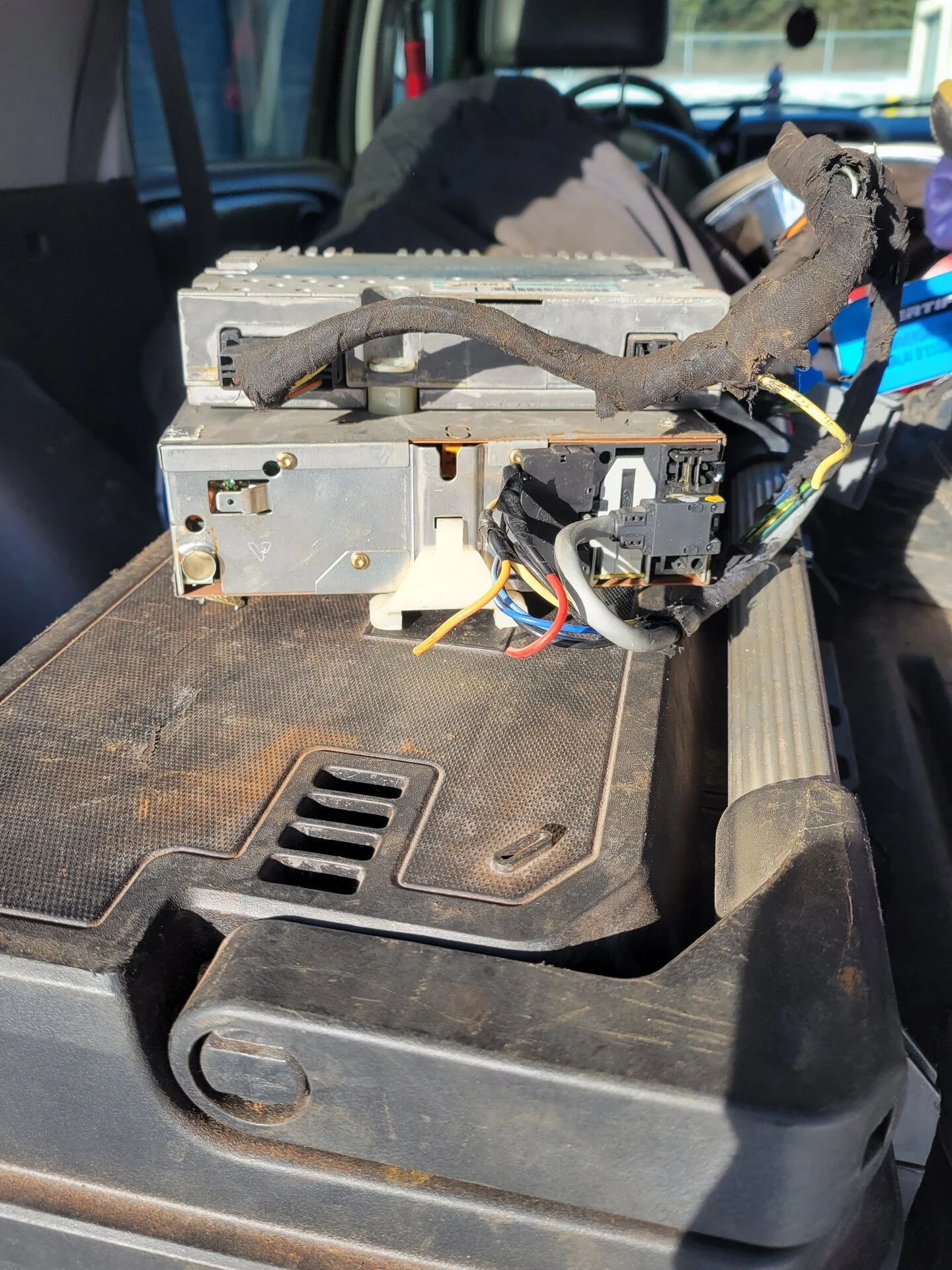

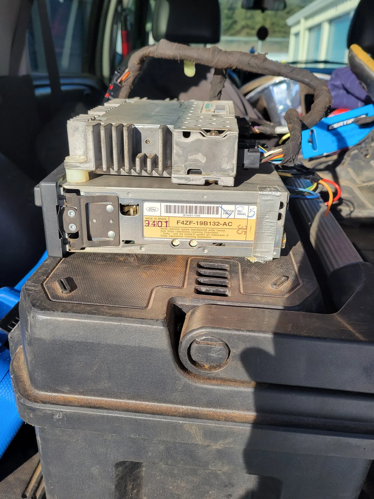

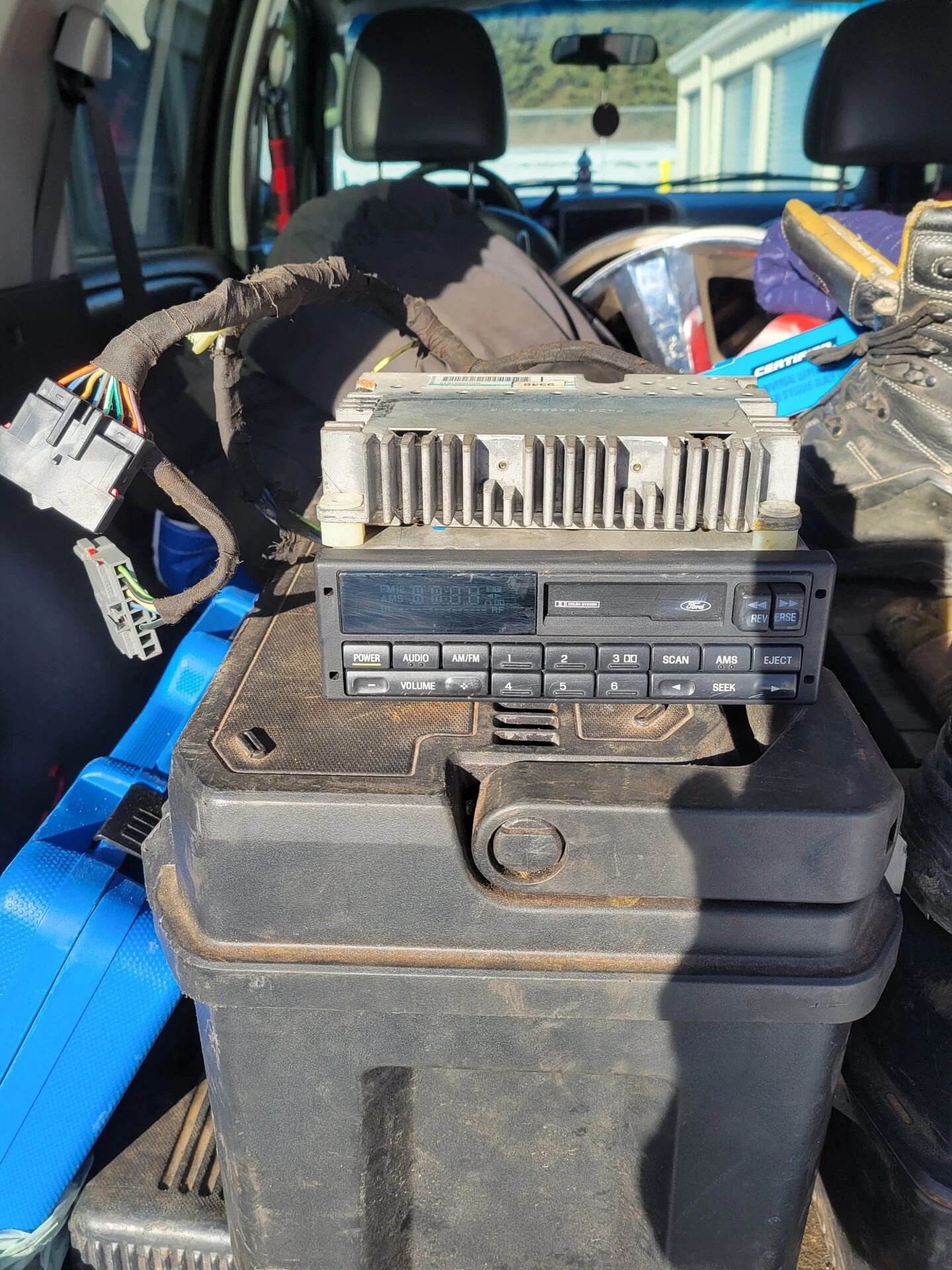

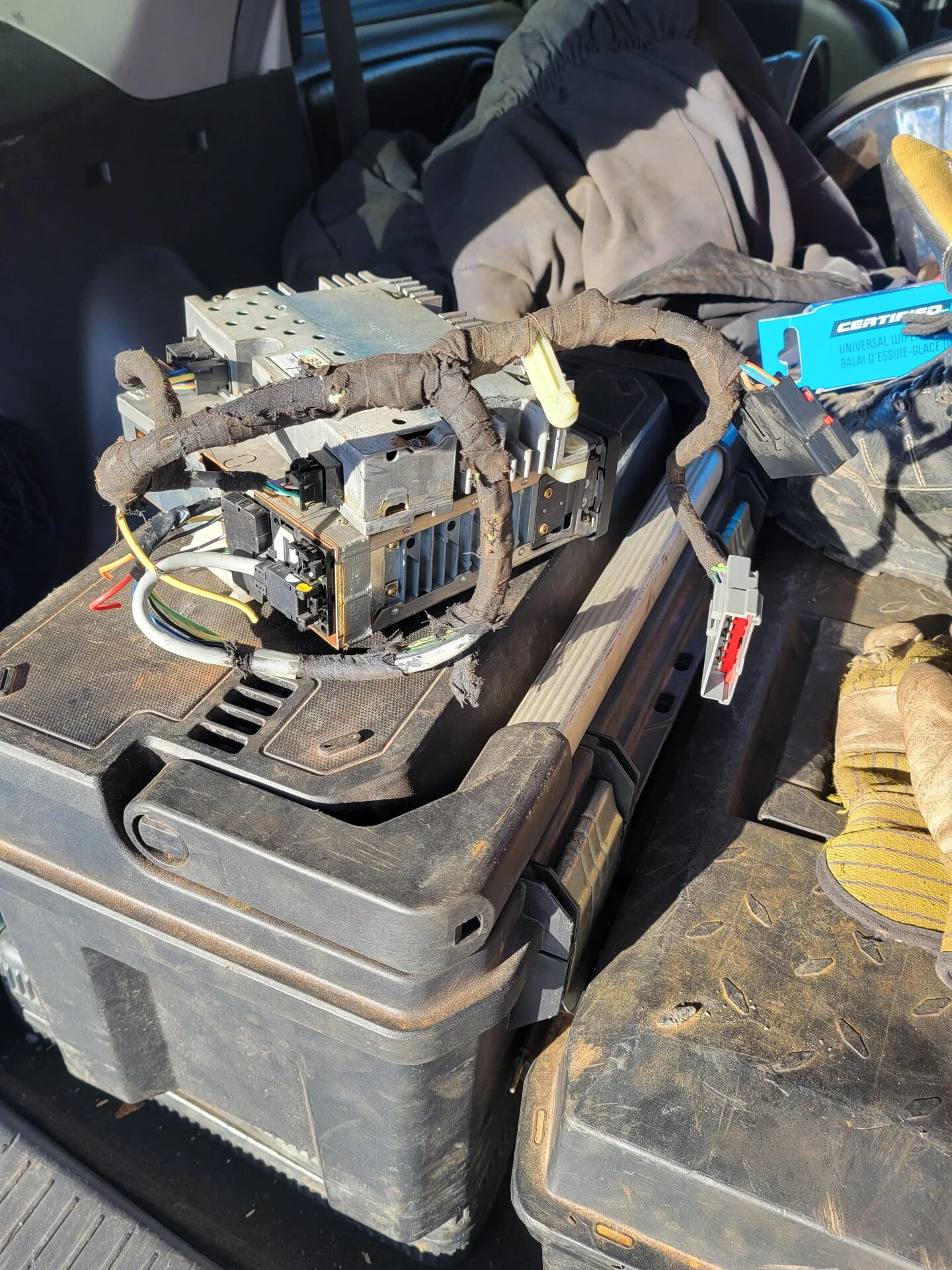

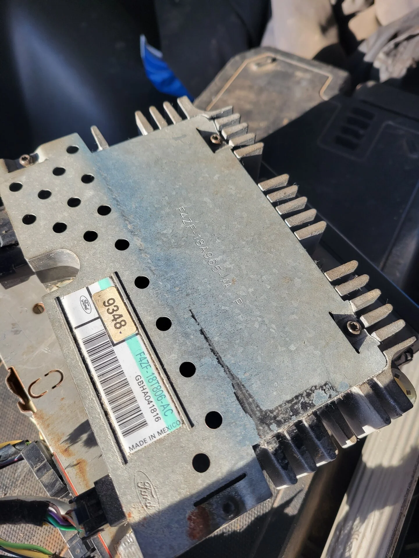

I pulled this from a 94 V6 in early November, finally got around to snapping some pics ...
20221214_103027.webp 20221214_103035.webp 20221214_103042.webp 20221214_103112.webp 20221214_103128.webp
I took the radio, amp and wiring harness. Aside from the yellow wire I cut (I assume it is a power wire) it looks to have a plug and play harness with connectors that look like they would fit the standard non-premium pigtails.

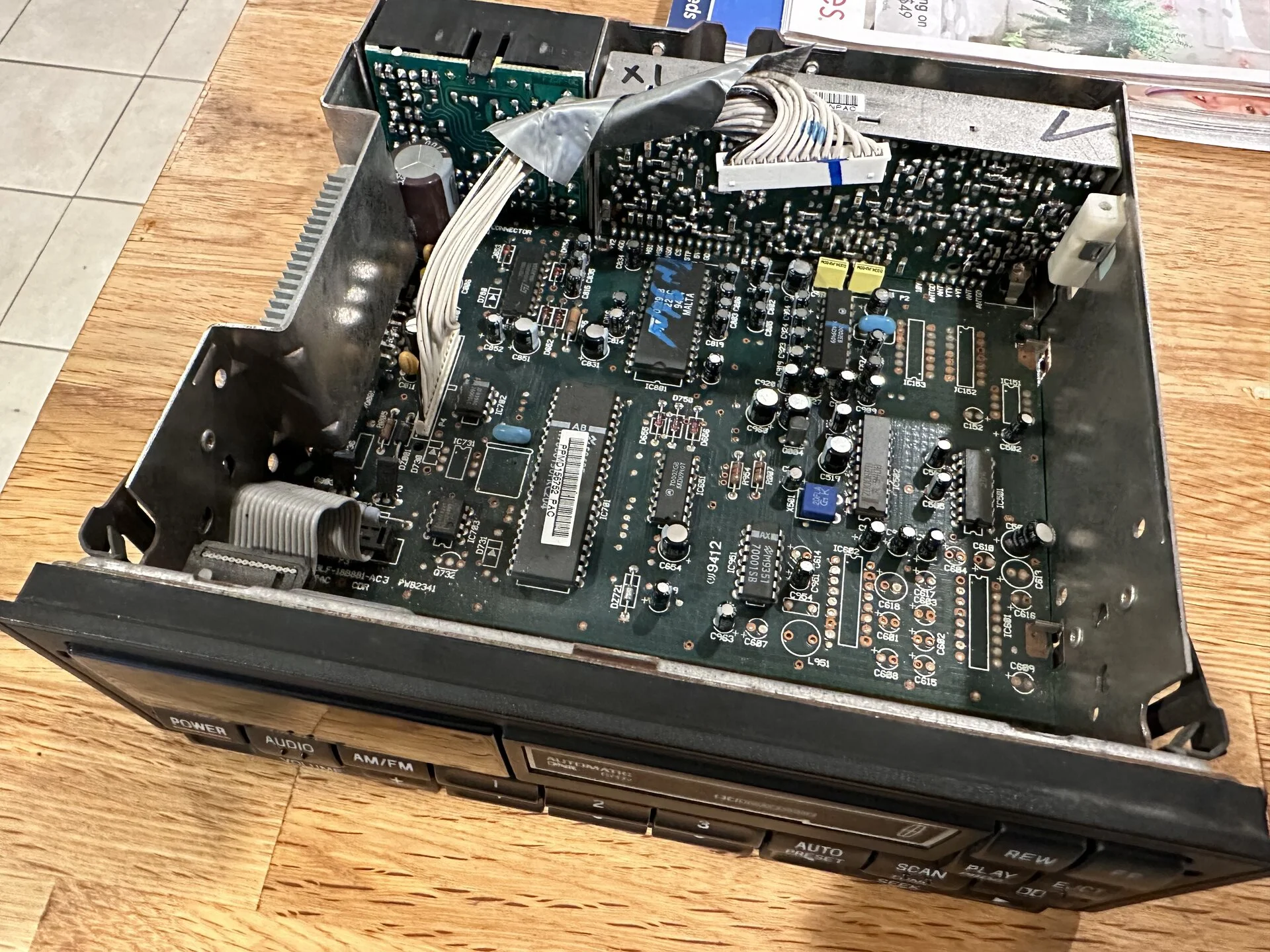

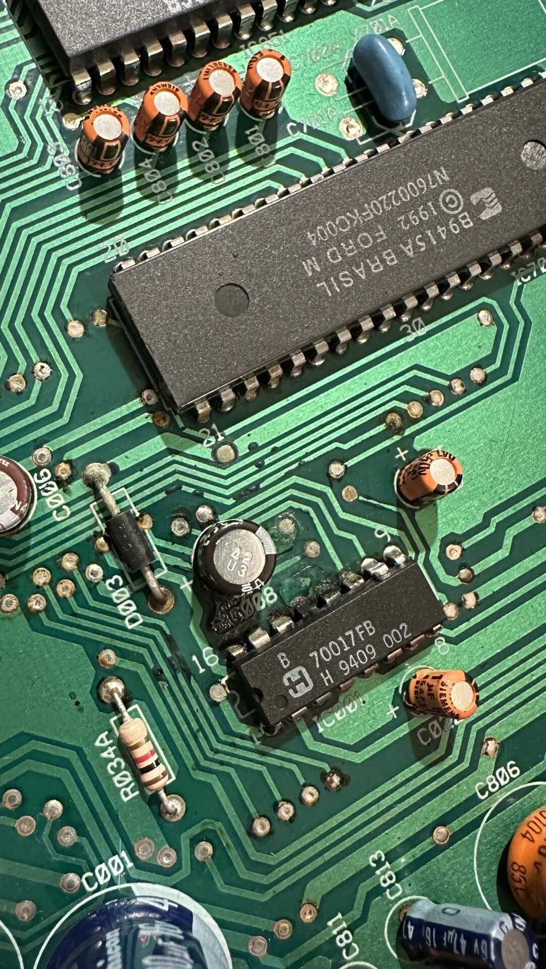

Started poking around a few of the bad radios I have to see about fixing them. This one turned on, but is forever stuck in TAPE
Well that doesn’t look good. Looks like that chip butned a little and some burned out traces. Unfortunately a it’s an obsolete chip. Found a supplied, but projected delivery time is MARCH!! Going to see if I can pull one from another parts radio to get this one going.
Wow that board is dirty. Is that flux residue? Looks like someone touched up that board and didn’t clean it after.
I don’t think it’s flux. I think the chip labeled IC001 burned up and that’s spatter. Hard to see from the pic but the side is melted out. I haven’t tested to see if those traces are burned. Once I discovered the chip was obsolete I just closed it back up and put it back on the shelf. That one is a 94 thunderbird non-premium radio, so I don’t have another one like it to parts swap. It’s forever stuck on tape, but doesn’t actually play.

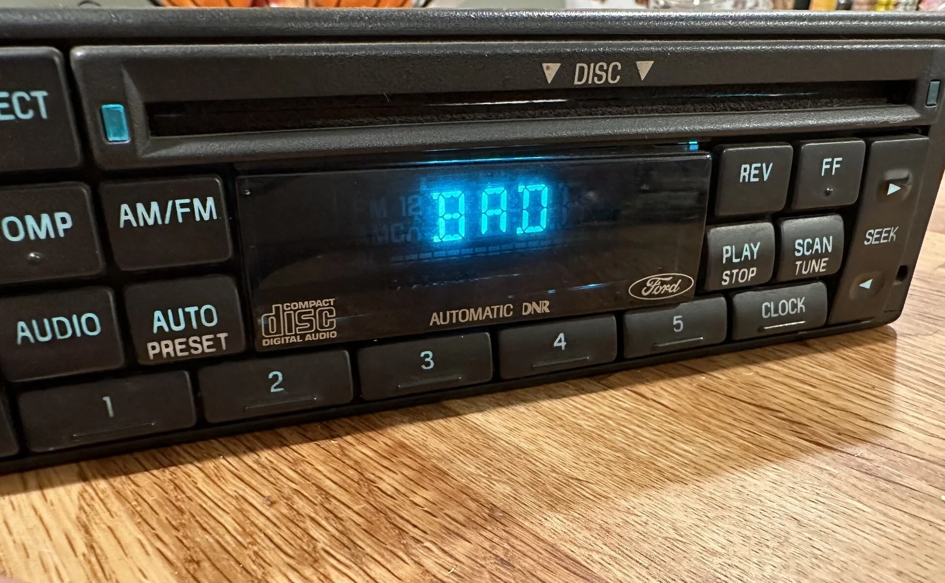

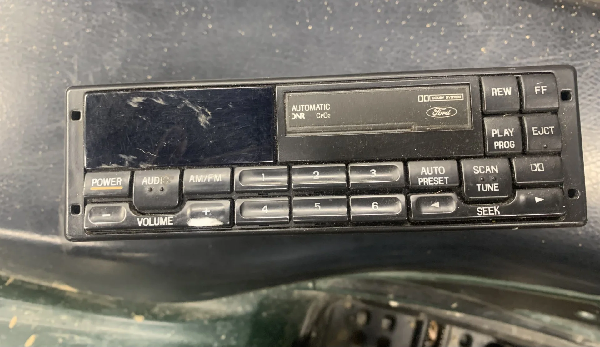

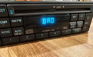

I fixed one radio that wouldn’t power on ( bad trace) but the CS player isn’t working and the sound is quiet/terrible. Another radio just shows this
You don’t say?
I’ve got maybe a dozen or so of these style cd players and tape decks that have various issues. Trying to parts swap them into some fully functional units.
This 94 Lincoln deck sounds great, but the tape doesn’t work. It’s similar to the 93 mustang unit. Trying to figure out where to tap the right and left channel to add Bluetooth. I found the individual 4-channels to the amp, but I need the left and right channel.
I did find a guy on eBay who was an audio tech unloading all his service manuals. I bought one for a similar 1993 style radio so I hope it gives me enough info to be dangerous. We will see. There’s no reference or schematics for these. The unit above shows BaD but there’s no service doc that tells me what that means exactly. I’m basically poking around and learning.

They are some of those IC’s on eBay. They are from china but it looks like they have stock. Might be worth a shot?
This is the item number. 392540514870
Look like a single layer board so you may be able to run jumper wires if the traces are burned.
