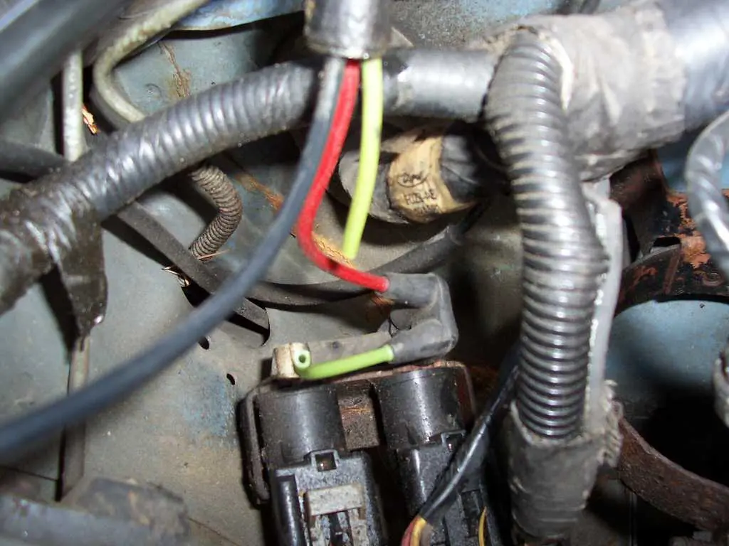

Anyone know what this is?
ninety2.3
May 4, 2002
186
PA
The little green plastic tube just broke on me. I was wondering if anyone knew what it was or does it need to be fixed. Its connected into the main harness and I dont know where it goes to. Its behind the passenger side strut tower.
attachment.php
What color wires are running to those 2 solenoids? If 1 is DG & R, it's the EGR vent solenoid and not much of a problem. If the other is Y & R, it's the EGR control solenoid and I don't think your EGR valve can operate without it.
