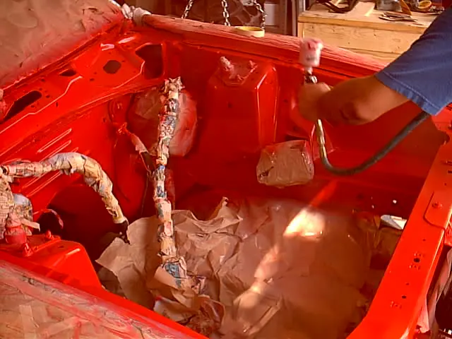

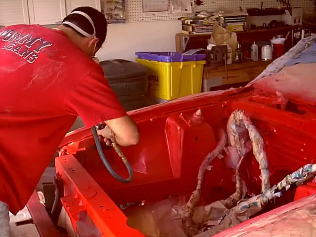

I paid to have mine painted but did the rest myself. Easily had close to 100 hours in it, but total cost was under $150. I could have painted it myself, but it would have actually cost me more in materials than what my buddy charged me to paint it. I used the leftover paint from the engine bay to paint the block and some other misc. parts.
