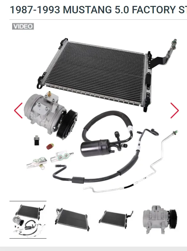

Anyone purchase/install the LMR R-134a conversion kit?
Stock '92 that had R-12 system, - tried to convert it to R-134A, and not super happy with the temps.
Was looking at swapping out the entire system with the LMR R-13A kit AND changing out the EVAP and HEATER cores at the same time.
Anyone install this kit and are you satisfied with the temps?
Thank you!
I bought that kit. It replaces everything except the evaporator. You can use it, just flush it out with an A/C flush. I wouldn't replace it unless it really needs it. Mine blows decently cold, and the new condenser is much lighter than the OE part. The hard line going from the condenser to the filter/dryer needed tweaked a bit.

Thank you for the input. Gonna try and keep these original components the more I think about it. Have to change out the liquid line and see if that was the issue.

I replaced the liquid line with LMRs... Temps aren't as low as the were with the OEM line. I wonder if the orifice tube is more restrictive, causing the difference. Temps aren't terrible but went from ice cold to just decent. Can't keep up on the hottest days.

I have the R143a conversion kit from LMR in my garage. Really, really want to replace the evaporator and therefore not muck up the flush of the existing evaporator. But then I'll want to swap out the heater core, vacuum and wipe down the HVAC box, and the next thing I know it'll be 2028 with the car still apart lol!
I've found the orifice tubes are all over the place on reproduction parts. The blow through test is the quick easy way to see. Blow through some of the lines and some are easy, and some are difficult.
The issue with this is the amount of pressure drop you get correlates to the effectiveness of your cooling. Some of the lines blow through way too easy which translates to poor performance. Easy flow = less pressure drop. Pressure drop is what creates that cooling effect.
But at the same time, too much pressure drop creates a restriction in flow and that also causes problems. So, there is a sweet spot.
