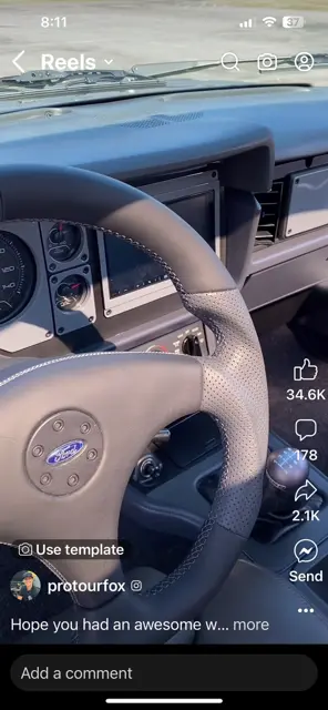

I saw someone with 85/86 Foxbody replace the hvac controls from later Foxbody years 87-93. They relocated the hvac controls to the stereo location and to put a touchscreen in where the hvac controls were. It may just be buy the hvac controls and see how it all fits together.

I'm curious as to what touchscreen was installed - did they enlarge the HVAC area to include the adjacent vent? I could see something like that working, especially if you wanted to install a Terminator X 7" touchscreen. Any pics to share to show what they did?
Here is a pic that I found.
That doesn't look half bad - I think the only thing I'd suggest for them is if they would've just made the surround the same size as the faux panel and basically bolted it in place like the panel emulates. I think it would probably blend even better than what that pic shows.
