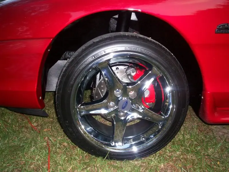

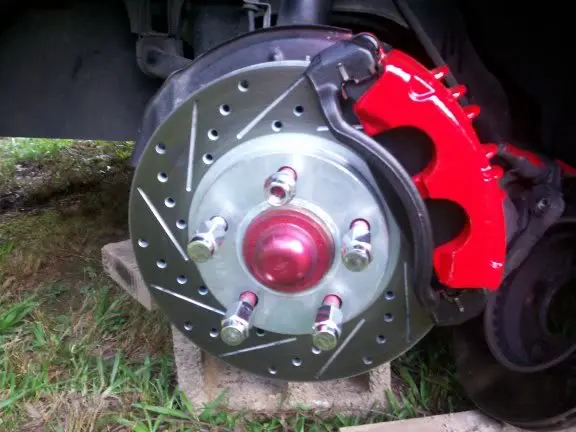

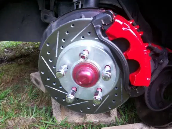

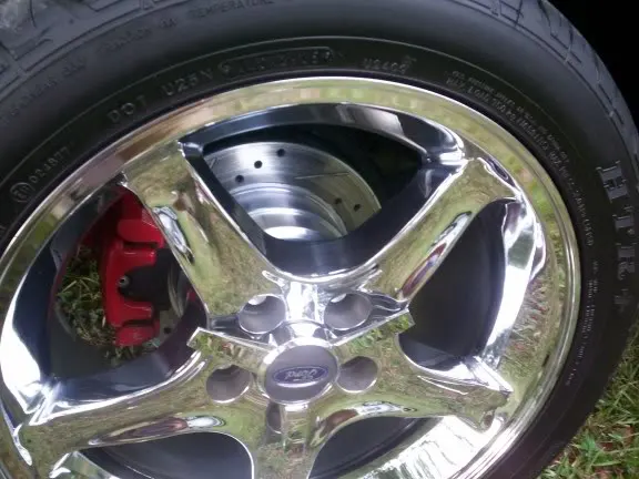

i have e-bay rotors similar to these http://cgi.ebay.com/ebaymotors/FORD...1QQihZ006QQcategoryZ33564QQrdZ1QQcmdZViewItem i have had no problems with them i installed them along with my pbr brake upgrade...just ensyre you buy the zinc coated ones..

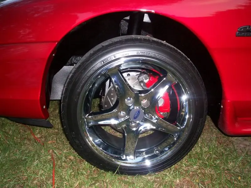

Damn! That looks nice! Think I will get the zinc E-bay rotors. Just about the same price as the stockers. What kind of paint did u use on the calipers & how well is it holding up? or did u get them powder coated? Looks sweet!:nice:

thanks...it was fairly easy to do..i used dupi-color paint brush on you can get it at most autoparts stores for about $20 check out this link... http://www.dupli-color.com/products/caliper.html just ensure you clean the calipers good before painting you can remove them if you want but i have cleaned calipers before with cleaner and a small wire brush and painted them right on the car after wheel was removed...if you dont clean them right the paint will crack and chip..
