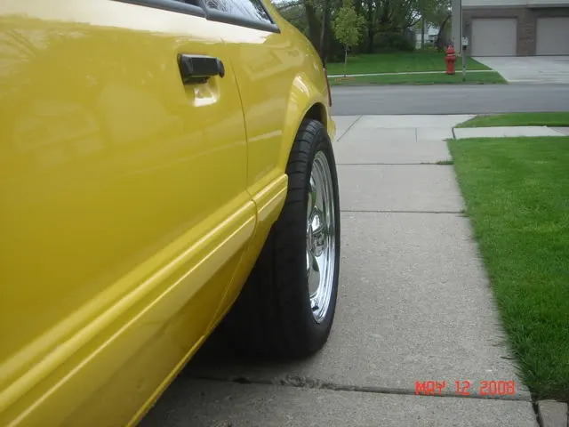

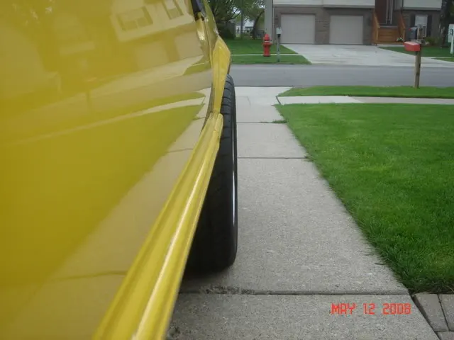

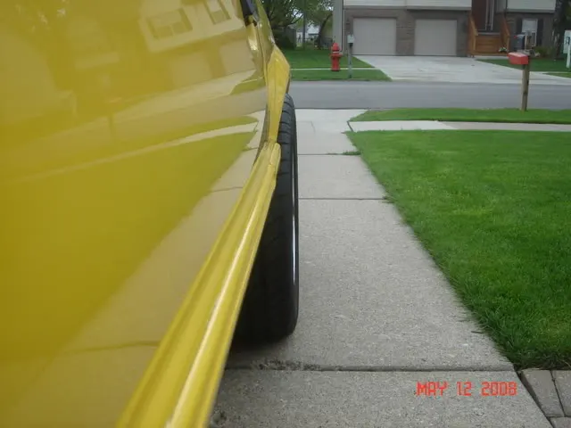

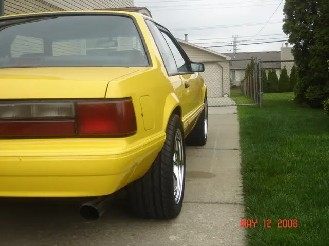

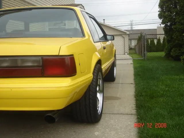

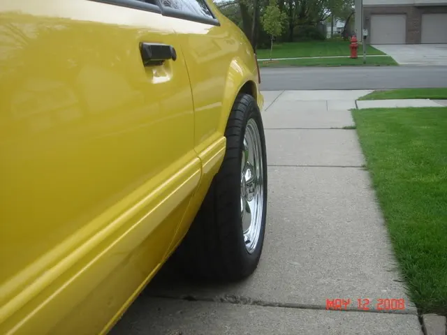

To give you an idea of where the rim/tire will be on the quarter panel. Here is a shot of my car.
HOWEVER:
This is a 99-04 axle with a 17X9" wheel and a +45mm offset, 285-40-17 tire. 275's would give you an extra 5mm of clearance on each side. 5mm at the quarter, 5mm at the inner well. Now....I did the math while building this car. When using a 94-98 axle with a 17X9 wheel and a +24mm offset (which is the same offset as the 18X9) the tire sits the same at the quarter using either combo. With as low as you want to go, get a tire no wider than a 275.
This pic is deceiving. The tire was 1-1/2" above the quarter. My friend said that while going over bumps it looked like the cars suspension traveld up and down about 1". I just welded some bump stops on the frame rail so those would hit the axle 1/2" before the tire.
I went cheap to not make the car not bottom out. I did not spend the 400+ on the weight jackers, I just welded some bump stops on the frame rail so those would hit the axle 1/2" before the tire. Free, and easy. BTW....those are Steeda Sport Springs model # 8200, and HPM Mega Bite Jr's mounted on the bottom hole and using their provide two 1/4" spring spacers on each side. These springs made my car very low, too low...so I needed that extra 1/2" on each side.

Thanks for the pics.

You are welcome. I just added some extra info during an EDIT, so go back in case you missed something. I got detailed because when I asked questions on here and other sites I didn't have too much luck.

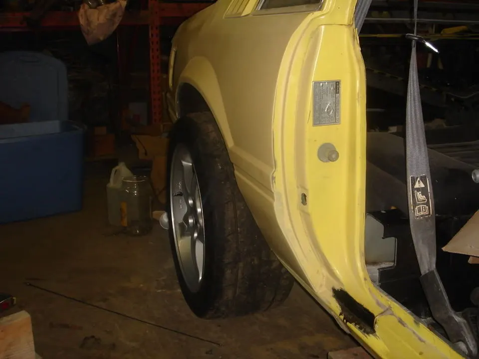

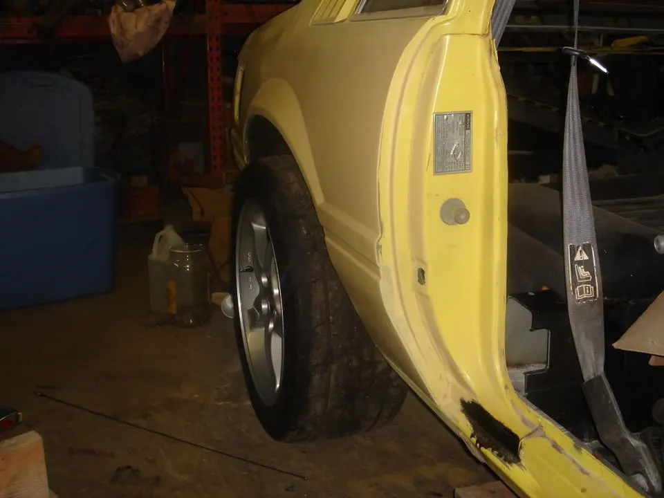

Here is a shot of a 17X9 +24mm offset Cobra r wheel and 275 tire. REMEMBER I used the 99-04 axle which is 1-1/2 inches longer on each side. The SN95 stuff is only 3/4" longer on each side. So picture this +24mm offset wheel sitting inward 3/4".
Your best bet is to use S197 offset wheels like 5L5 said. And that is what I used in my pics above. In the pics above with the S197 (+45mm offset) wheels, if I had the SN95 axle, the wheels above would sit inward 3/4" giving more clearance for a low vehicle.
