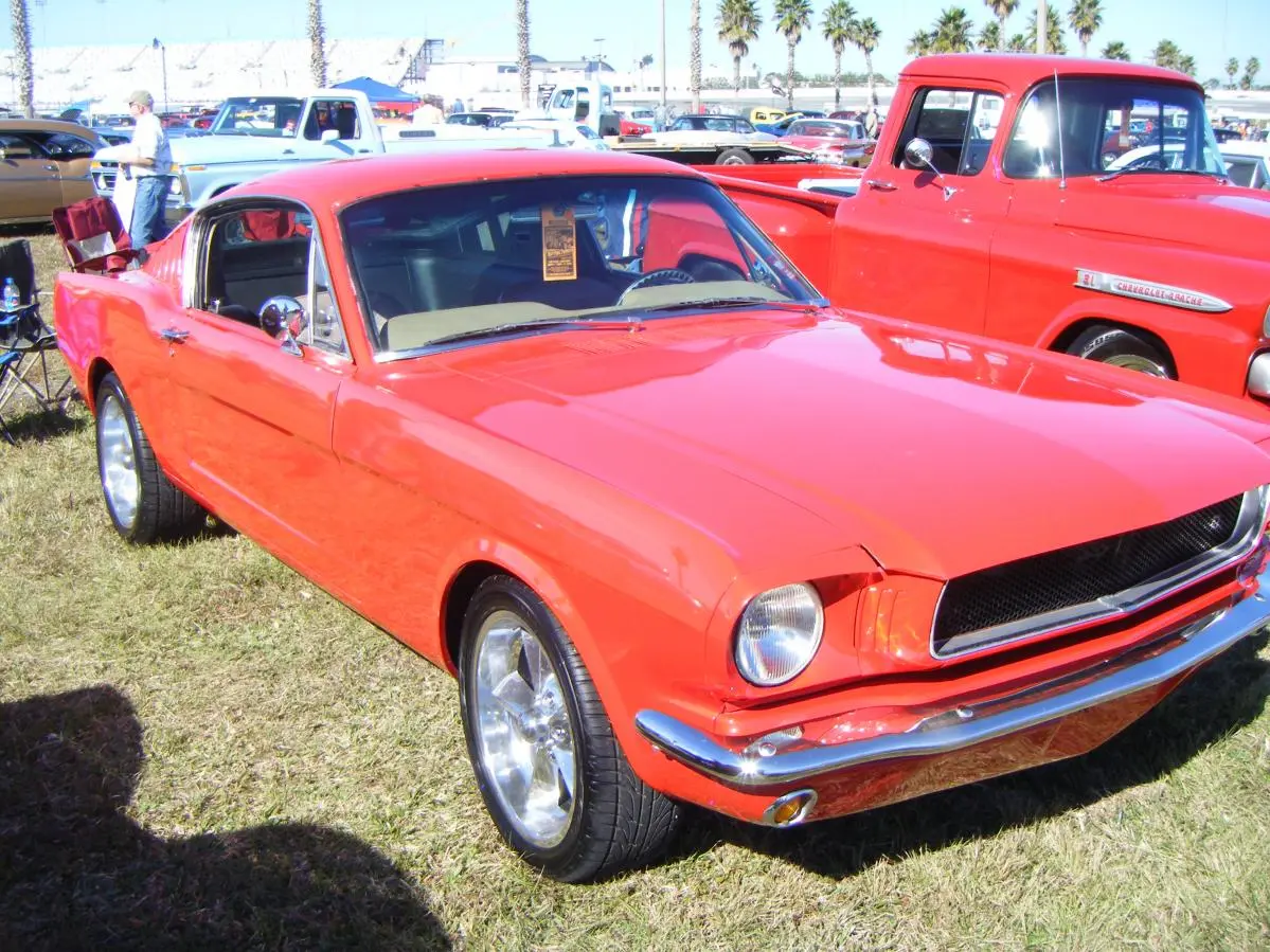

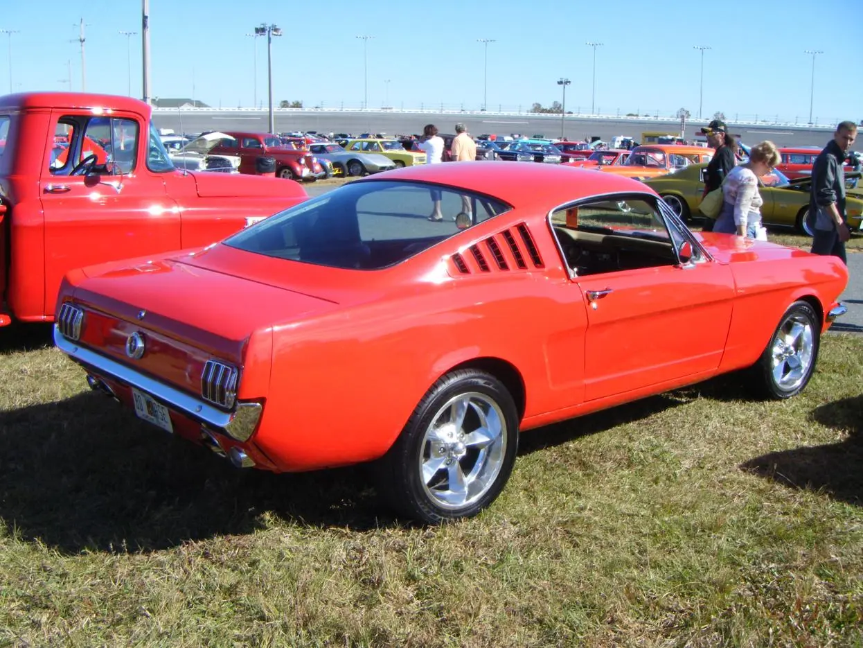

I have a 65 with 17 inch Coys. They are priced right and they will help with fiment. coyswheel.com. Delivered to my door with tires for just over a grand.
