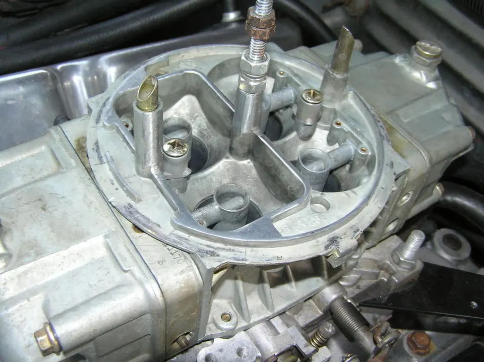

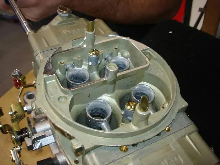

I ran a 650dp for years, ran awesome. I dynoed my 347 with the same carb i ran on my stock long block 302. The guy who tuned it was going on and on about how the duel plane intake i was running would only let me rev to 5500, and how the breather was gonna choke it out and on and on. Then it spun the rollers and he couldn't believe that it had just made more rwhp than another EFI 347 he had recently dynoed that had fancy aluminum heads on it. Then we took the breather off to see if it was choking power, and the A/F was all over the place and it put down LESS power. He said "whatever you do don't ever run another breather but this one".

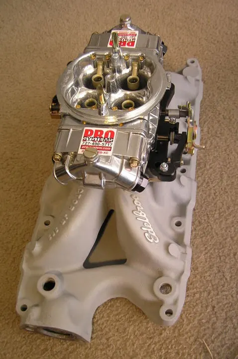

When i got the cash, i stepped up to a Pro Systems custom built carb with a fancy NASCAR main body. I haven't been back to the dyno but between the carb and a Vic Jr. intake swap the car pulls way harder. I'm suspecting the gains are mostly from the intake swap though.
My old Holley
My new fancy pants Pro Systems 780
Oh, and i've started both of these carbs in the dead of winter...two pumps on the pedal, fires up first crank. Sure, it doesn't idle on it's own and you have to sit and goose it for a couple minutes to keep it running, but after two minutes or so it idles fine and once it warms up it runs like any other carbed car in the winter. If you WANT to run a choke, i'd suggest an electric over a manual choke. I got the manual because i didn't want to fool with wiring the electric, and i never used it so i took it off. I even spent the cash on a manual choke cable...waste of time. Just go electric and be done with it, or nothing at all.
My old Holley
