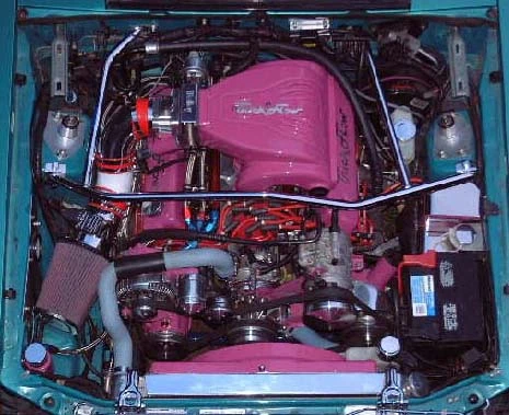

I was wondering what kind of power you yall were making with this head.
I am building a 392W stroker EFI motor. I am leaning towards buying these over the victor jr's. Its going to be a NA setup And I am guessing that I should be making around 420 RWHP. Any advice greatly appreciated! :flag:

I run the TFS "R" heads, kinda in the same category. 418ci, 11.25:1, custom cam, super victor, 1000cfm demon, 1 7/8 long tubes ect.... On pump gas, out of box parts motor made 581fwhp, 539fwt. Peak hp was at 6500, torque at 5000. I think if I had gone with the victor jr and a cam with a little less duration/overlap I would have made 530-550fwhp and 550+ fwt, and made peak a little lower.
I agree with HO Train. I think you may be pleasantly suprised with your combo, especially if you have AFR and Ed Curtis on your side. :nice:
My little 306 is using 30# injectors at around 38 psi when fully warmed up. I should think with nearly 400 cid and AFR 205's, your combo would benefit from something around 40#. If you have further questions, I'd consult with Ed Curtis, as I would think he would have put several similar combos together.
