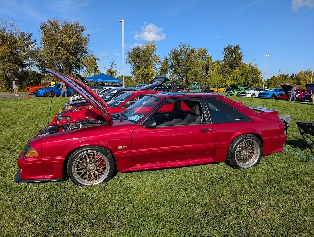

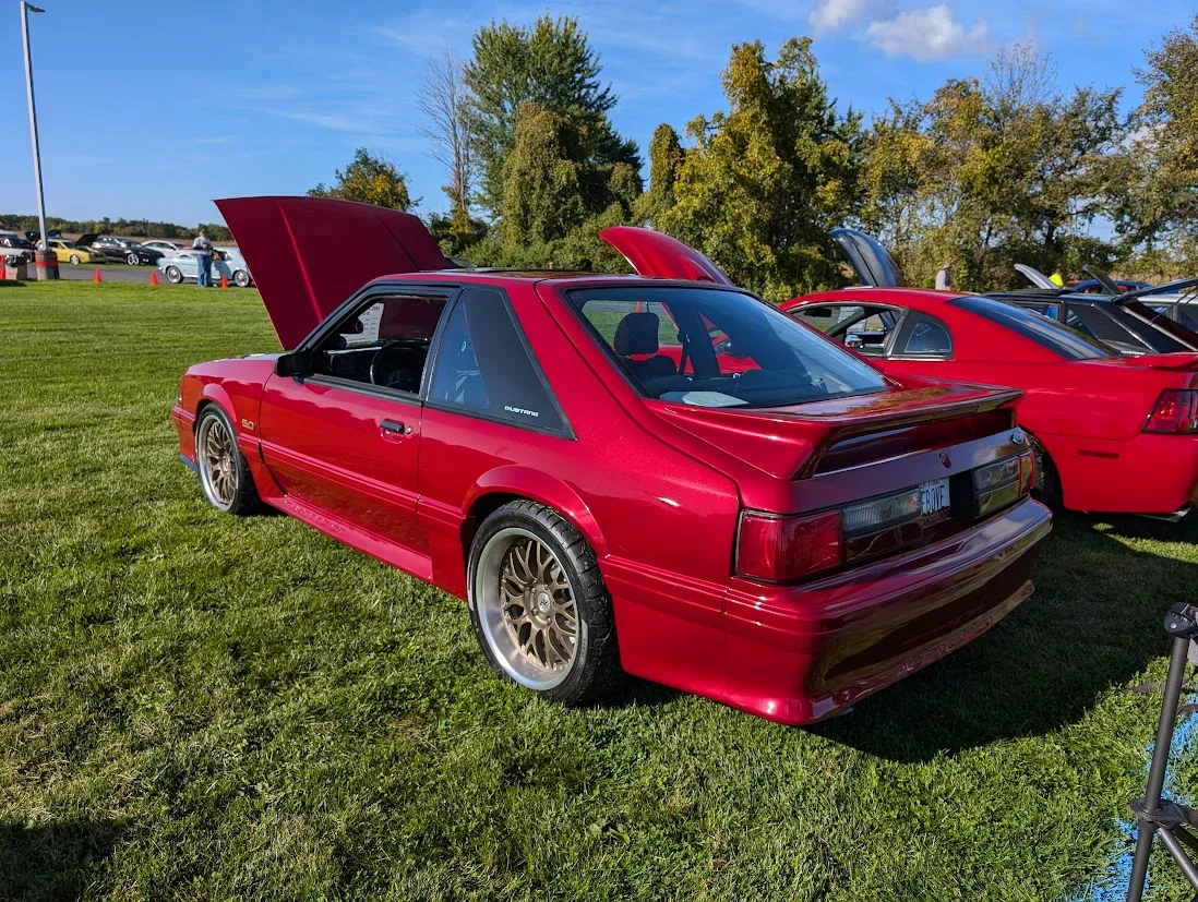

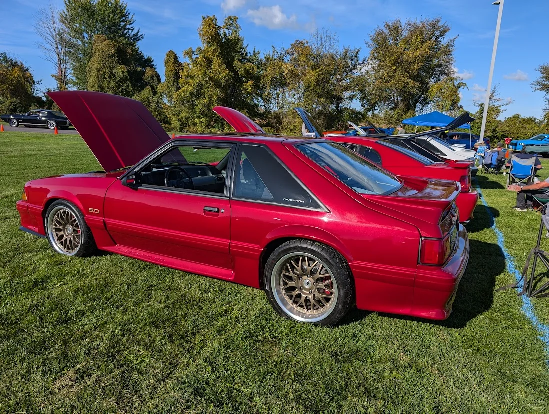

Fox Anyone running sve series 3 wheels on their Fox? Pics?
Random pics off of a Google search...
If you look on LMR's website in the reviews there are a couple of reviews with pictures of Foxes as well.
Reactions: Shakerhood

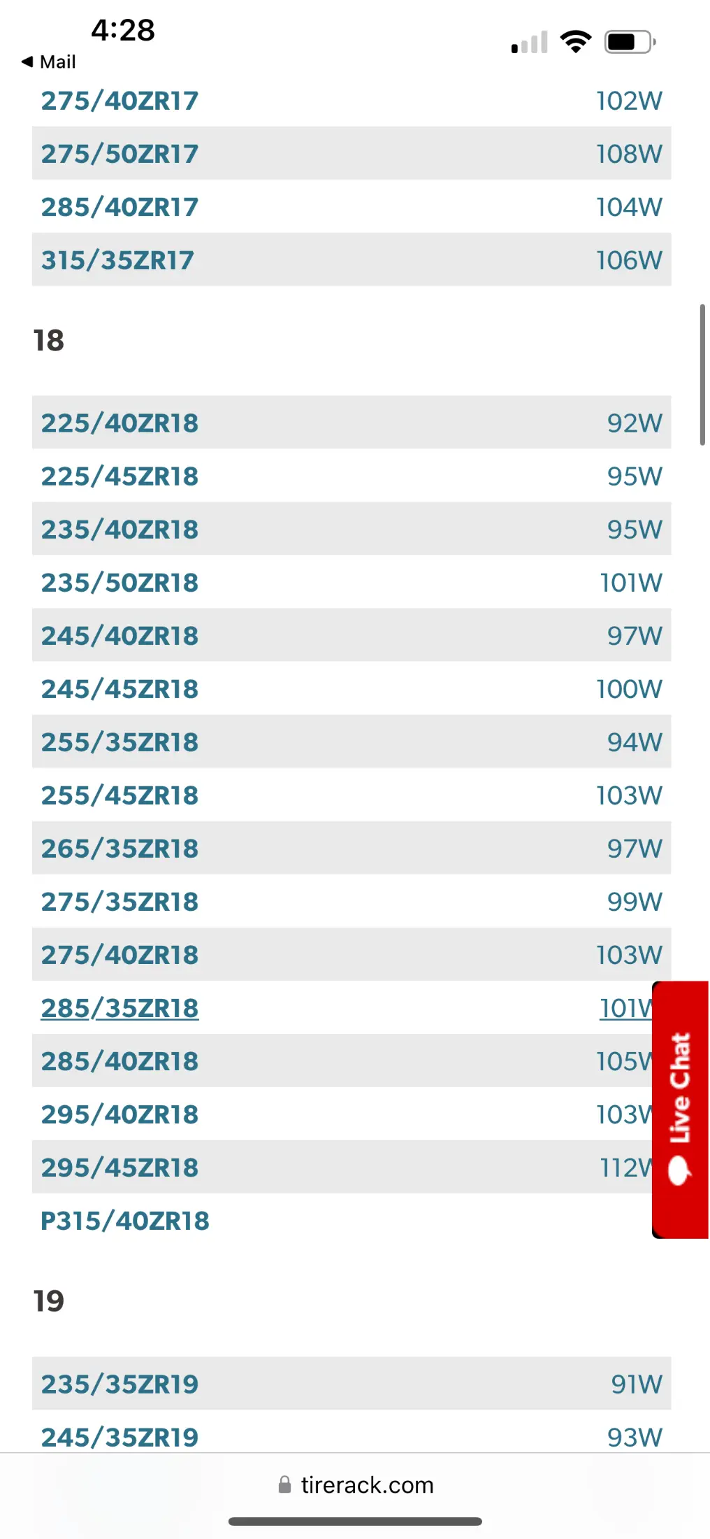

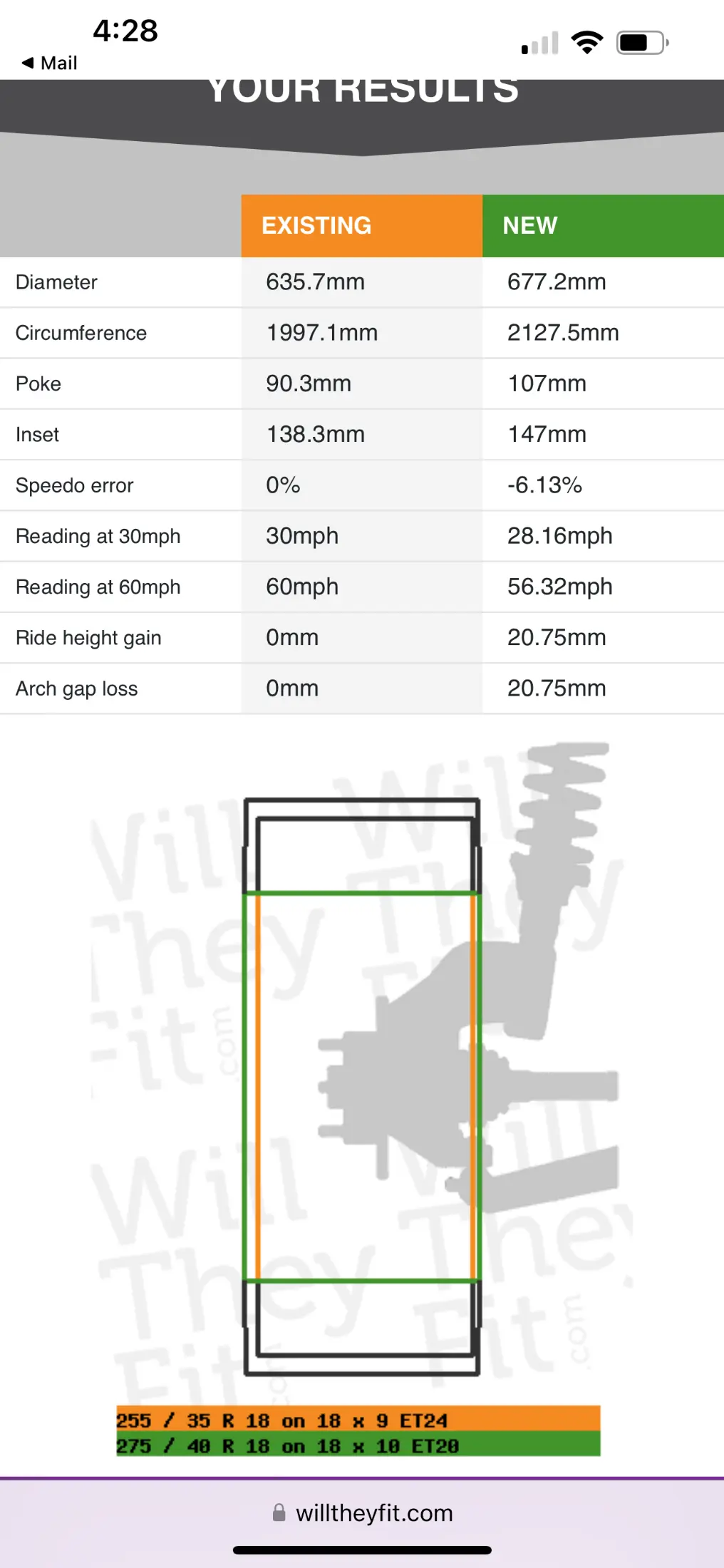

Can I run a fatter sidewall on the rear tire or should I stick with around the same? I plan on doing 275/40 in the rear, and 255/35 in the front. Cause I think a little more meat in the back would look cool. But I’m not sure if this will be too much of a difference in tire diameter, and cause issues or look weird. Let me know what you guys think…
Below I’ve attached the tire sizes available and also the size difference for that setup I mentioned with the front and rear.
