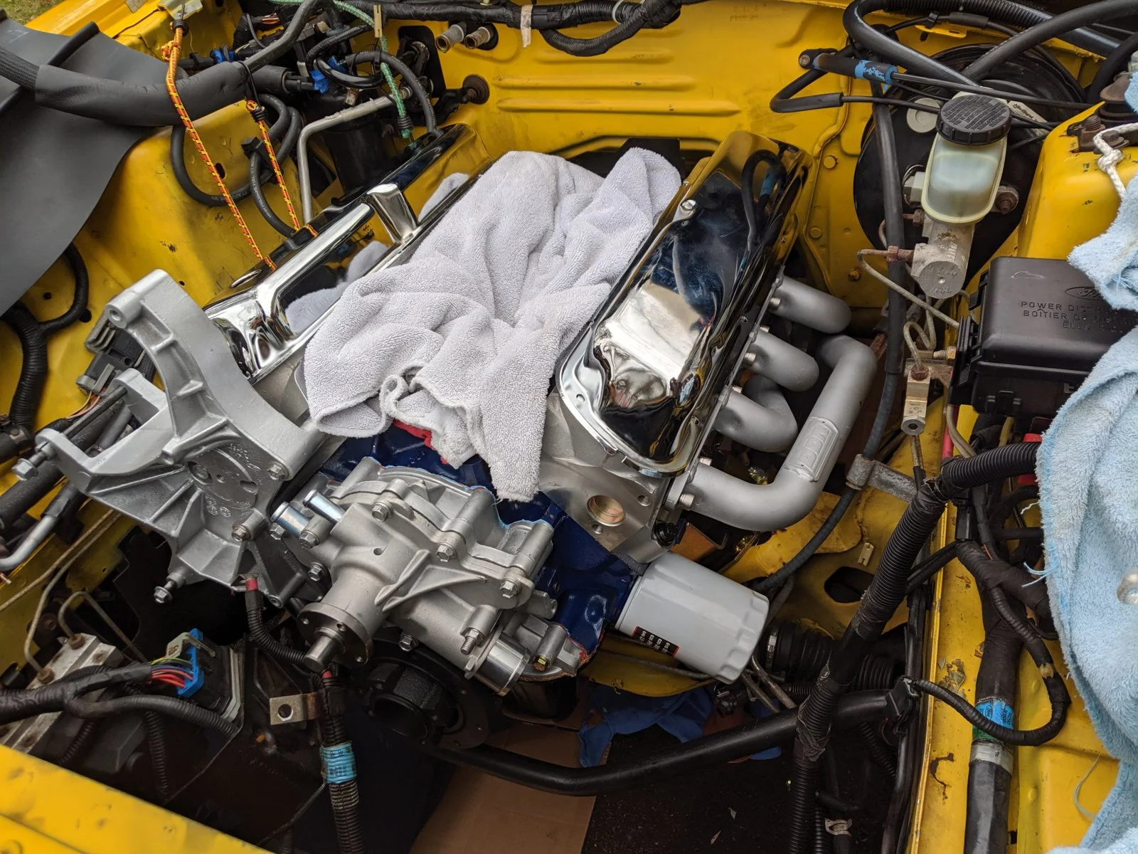

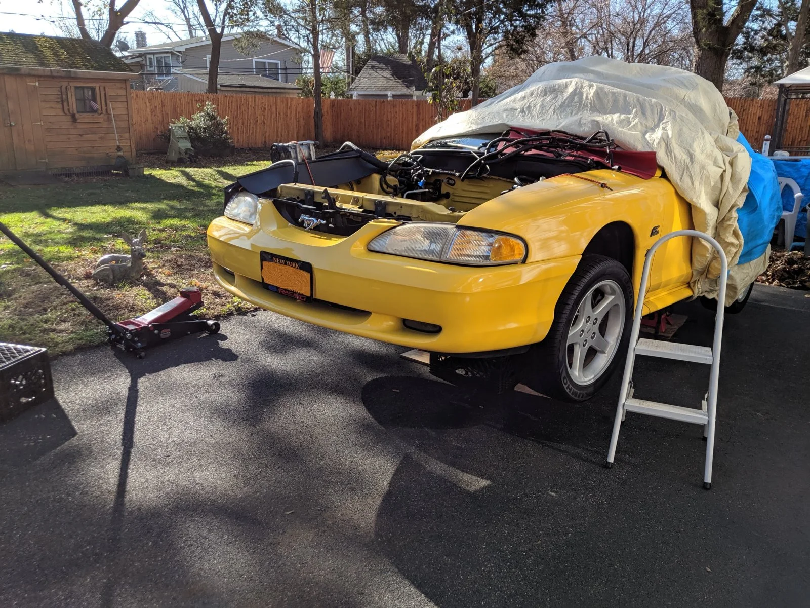

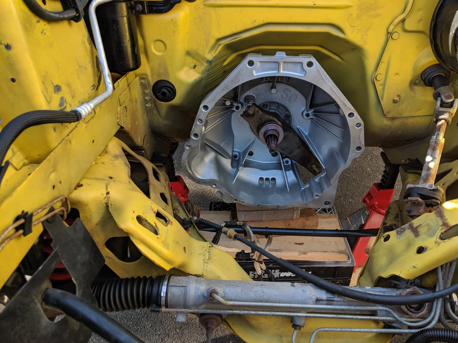

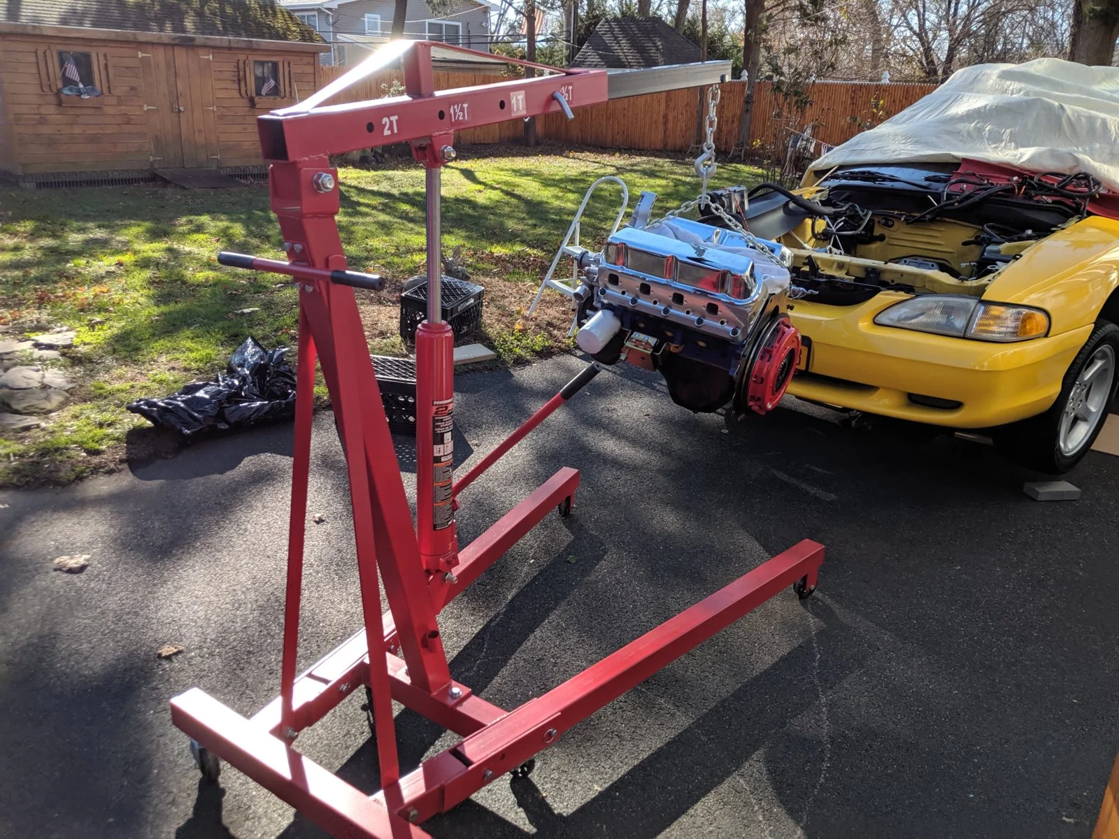

The project has been moving along. But slowed with the holidays and shorter daylights. The engine is out of the car and the crate motor has arrived. Swapped the brackets, rebuilt the T-5. I'll have more details as it's coming all together.

Here are some pics. Project moving along
