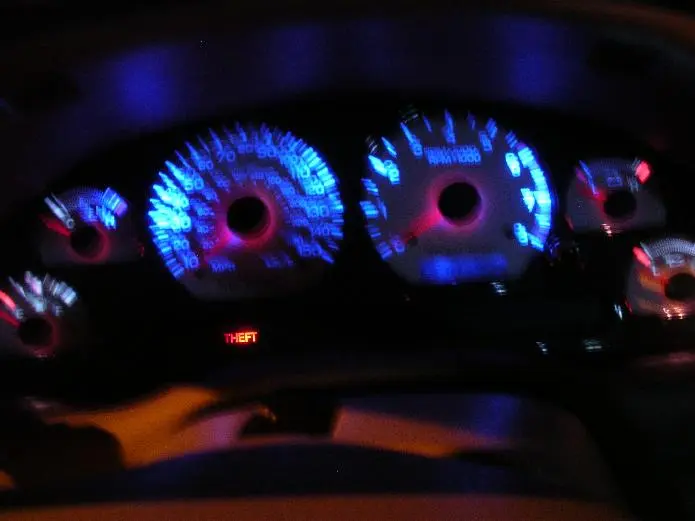

if i remember correctly there's somebody on here that has a saleen that did actually did swap in some blue leds into his gauge cluster. he has some pics too of before and after. hopefully he'll pop in and give us a little more insight on what was involved.
Ask and you shall receive....
Those pics kinda suck cause of my digital camera, but they are varad 3 led bulbs (194). You can get them at www.sounddomain.com. Mine is a 98 and I had 5 bulbs in the back of the cluster...194's

There is a guy on ebay who sells blue LED's that plug in directly to where the stock bulbs fit. I can take a picture of the LED's if it would be helpful. They do make the gauges light blue, but they don't disperse light as well as bulbs, resulting in bright & dim areas.
