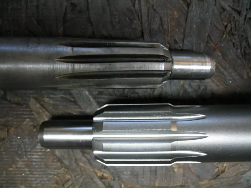

Install an aftermarket big block input shaft. They are made in the same 1 3/8" 10 spline diameter as your shaft, but the pilot bearing length is long, like a small block. The extra length allows you to trim the length to match. I got mine from Mark at www.toploaderheaven.com David Kee sells them, as do other toploader parts dealers.
Here is the one that I purchased to beef up my small block toploader (next to a the small block one):

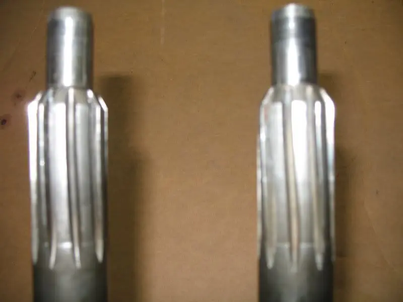

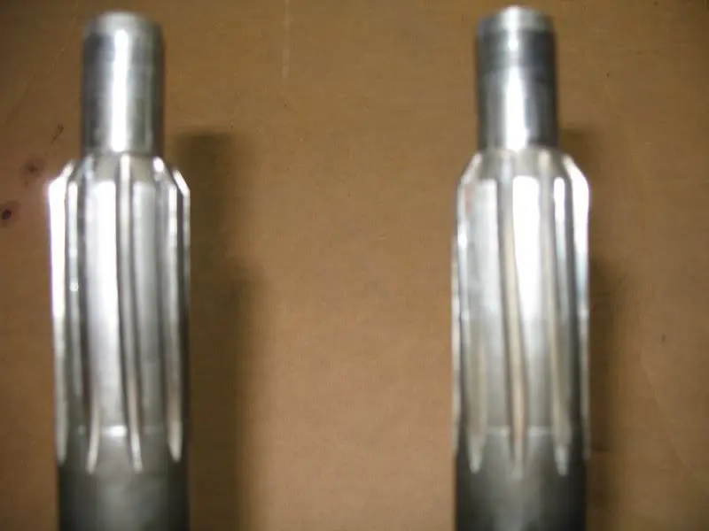

Why did my small block car need this? Because 2 consecutive trips to the track with sticky tires resulted in "barber pole" input shafts like this:
Remember that it will require the BB clutch disk.
