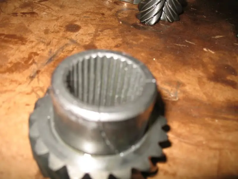

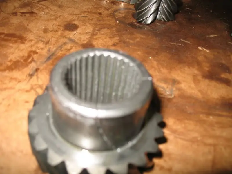

I've reached the point with my car where it is time to upgrade the both the SB tranny and the rear. In the last 2 weekends at the track I've done this to my toploader:

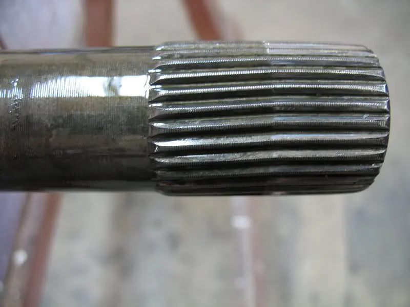

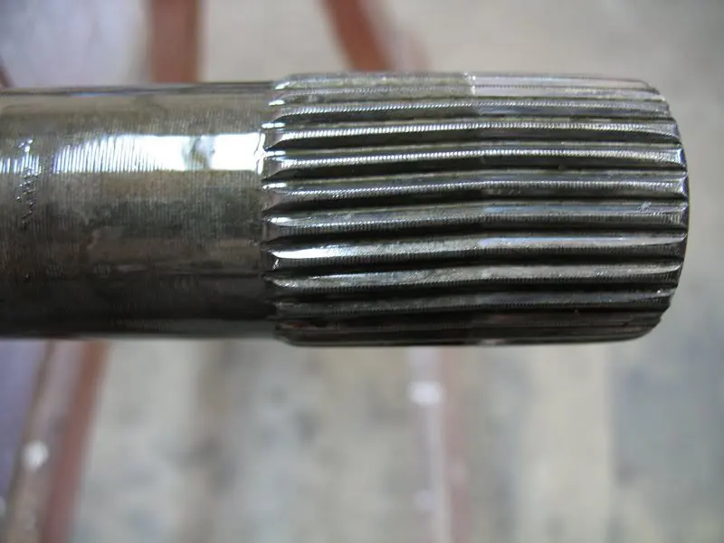

And this to my 31 spline 9" rear:
Luckily I had another input shaft on hand and that was a quick cheap (and probably temporary) repair.
I since replaced the axles and the True Trac with 33 spline Moser stuff--including a spool so I should have that beefed up enough for the time being. I also got the new axles lengthened so that they take advantage of using more of the splines.
