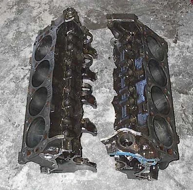

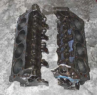

The problem with the stock blocks is not twisting; it's strength in the mains. They don't split from the top down, they split from the main bolts up into the valley. I'm convinced that the only possible savior of the stock block would be a huge one-piece maincap/girdle that bolts to the pan rails. Kind of a Band Aid way to get the same effect as a 4-bolt bottom end.
Here's the factory lightweight right here:
:D

My mistake, two 1/4-20 bolts.
:D
Ah...this minor engine problem could be patched up with a soldering iron, duct tape, and couple of 1/4" bolts. Also I would keep the NO2 shot down to 150 or so, because of duct tape flexing at higher HP levels. :rlaugh:
