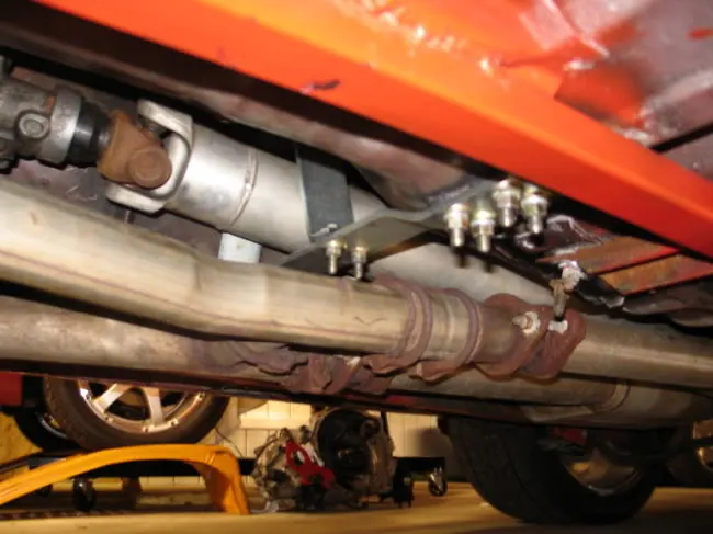

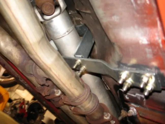

So holes have tobe drilled , i thought i have to use rear bolts from seats (mine are already used for subframes)
BTW where it mounts before or after those rear seat bolts
Installed
Here is some pics
BTW I wasgoing to buy new Off roadH-pipe buti going with different set up so i gonna keep it for now
