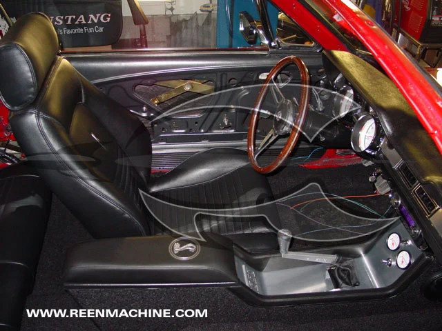

I bought a Hurst stick that came close to my needs and then repositioned it by cutting and welding the mounting flange. It worked out nicely and the chrome stick with white ball 5 speed knob looks really nice. If the Hurst people hadn't been so clumsy to scratch the knob before putting it in the plastic, it would have been even better....

atomicpunk said:
What shifter is that ?
iskwezm said:
I have a Ripper and NEED that handle. i have monkey arms, so the reach isnt bad into 5th, but with the 5 point harnesses on, i cant lean forward.
I had it made at a CNC shop and I have a couple more -- it says REEN on the side. :)
I am planning on selling them in the future, but don't have the final version yet. Perhaps I can help you out though. Let me know.
so PM me whatchu got. And my parents were just in Flagstaff last month,they coulda grabbed it for me:D
