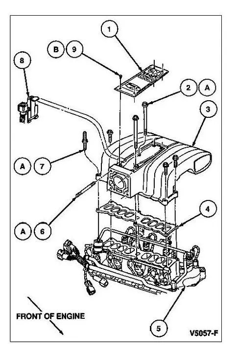

Please help, are there more than 4 bolts?! anything that can be missed... I am having so much trouble trying to remove the upper. I've removed four bolts, and i CANNOT break the seal, so im wondering if anyone has any hints...if im missing a bolt somewhere that is hard to see, etc. I've gone so far as to use an engine crate to pull on the underneath of the upper (in the crevice between the lower intake) and instead of it coming right off, the entire motor starts lifting, and then the entire car starts lifting off the jackstands.
STOP!!!!! take off the 5.0 HO decorative plate... there are 2 more under there... and there is one people always miss DEEEEEEEEEEP in the middle of the runners i think its a torx bit...... and DONT FORCE ANYTHING... not worth your time if you break it...

AHHH! Remember: work smart, not hard. In my experience, any time you use BIG tools (sledge, crowbar, ENGINE HOIST :D ) for a job that doesn't usually require said tools, you're going to break things you don't want to break. My advice to you is to purchase a Chilton or Haynes manual for the car, and read before you dive in. It would have told you that the upper is held in place by 6 bolts, not 4.

Also be aware that if the intake has never been off before you will have a U-shaped bar (not shown) that connects from the stud on the upper (A7) to a stud on the lower intake. At the very least the nut on the lower's stud will have to be loosened in order to move the bar out of the way to remove the upper.
