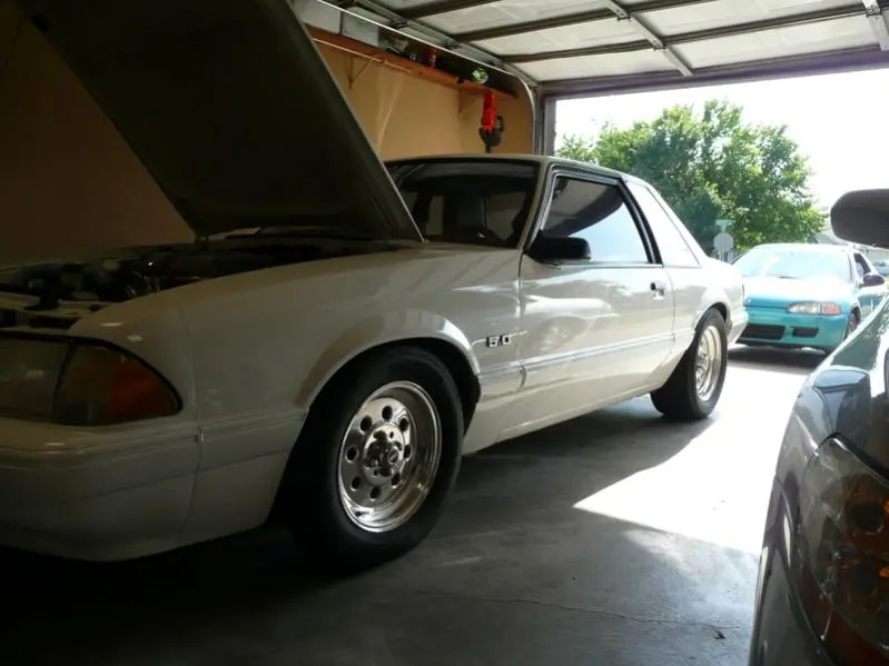

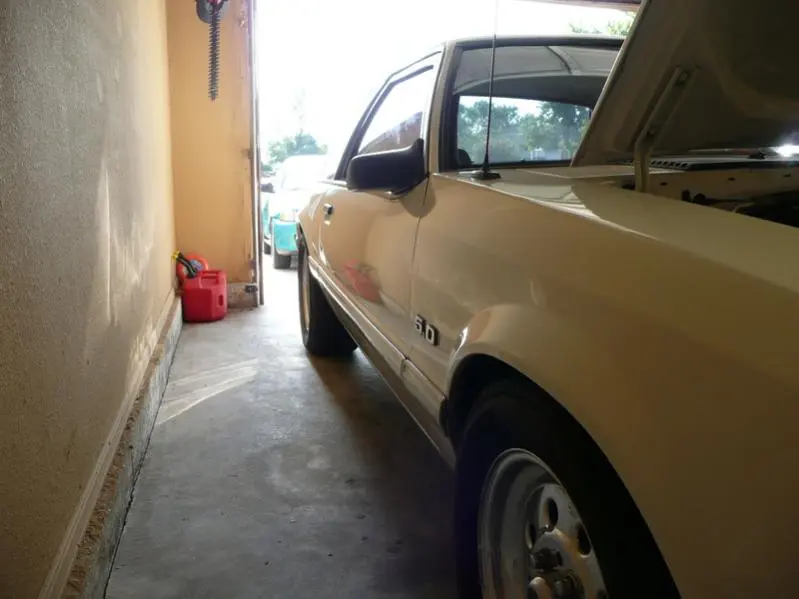

Here are some pics of the car before i picked it up!
