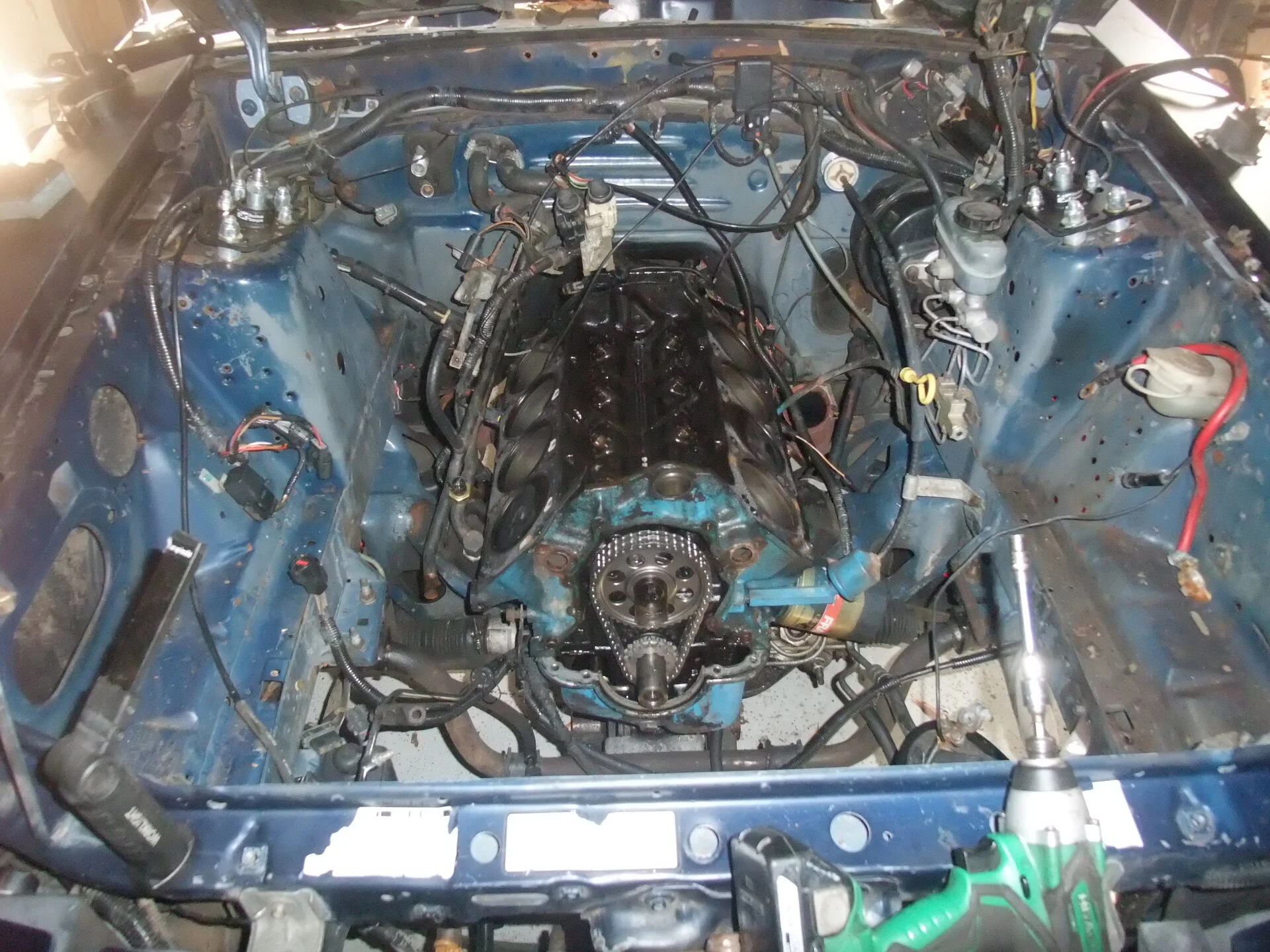

There is no after yet, here's a in progress pic. Just cam and new timing set installed. It's also getting an alum rad and 134a AC swap.

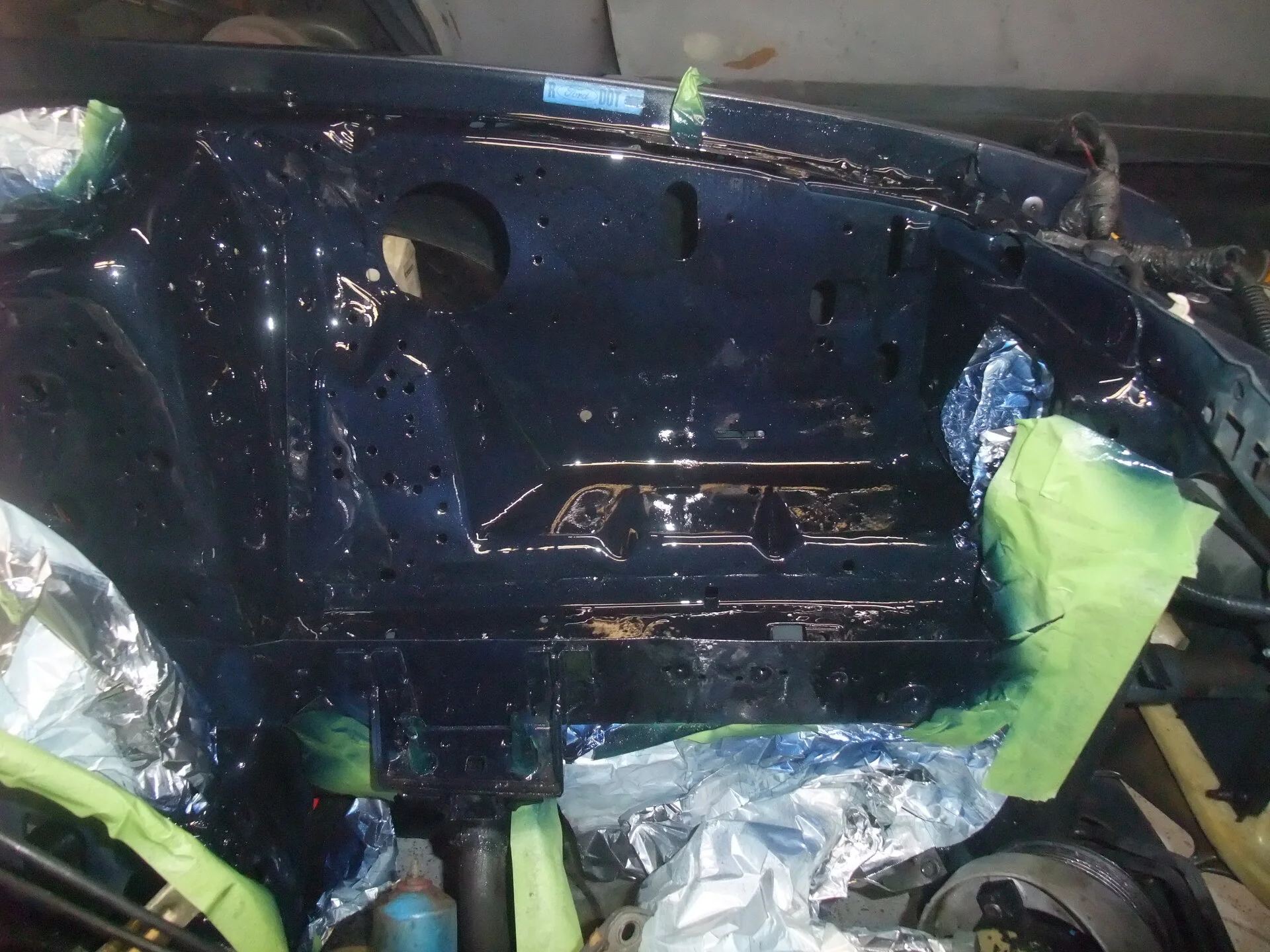

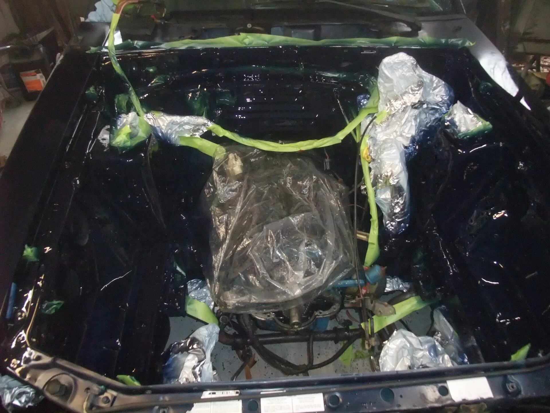

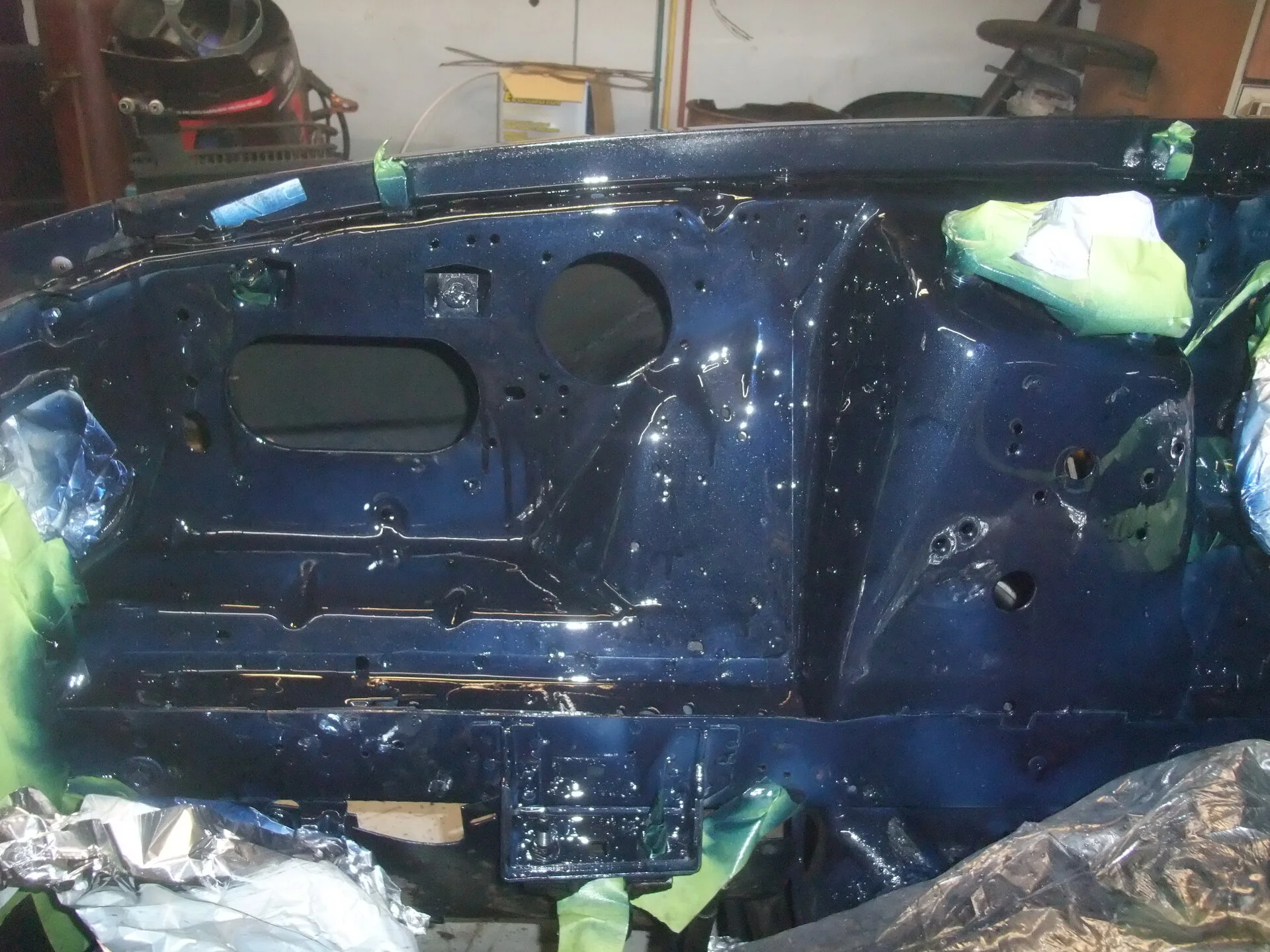

Todays trick was painting the engine comp. Really like my new 3M accuspray.

Looked at it closely w a good flashlight. Terrible job but still much, much better than it was....I hadn't painted anything in a long time and forgot to take a break between coats so its full of runs. The surface is smooth the runs are in the metalflake. Next to finish the wiring tuck and reassemble it, sucks the weather is going to crap, as in cold, for the foreseeable future. I also plan to eliminate the salt and pepper shakers w crimped and heat shrink connections. And while doing this diagnose whats wrong w my Megasquirt bank 2 wiring. So that way hopefully the new version of the engine will run w it. I understand the 19 lb injectors will only support about 310 HP and w the MS it will be easy to tell if they are too small.

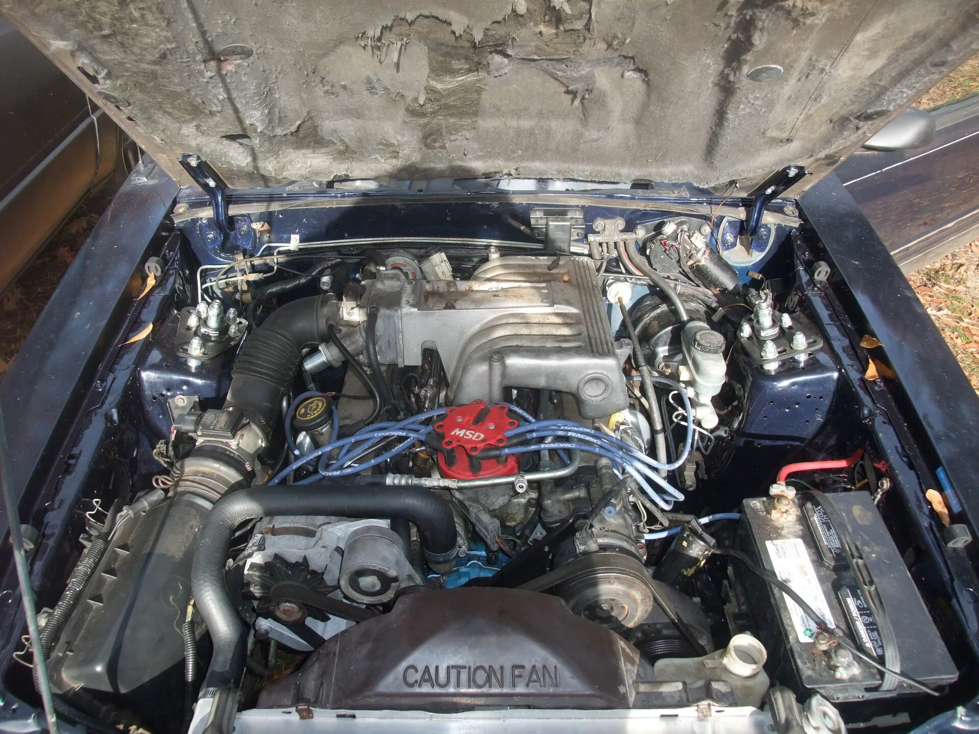

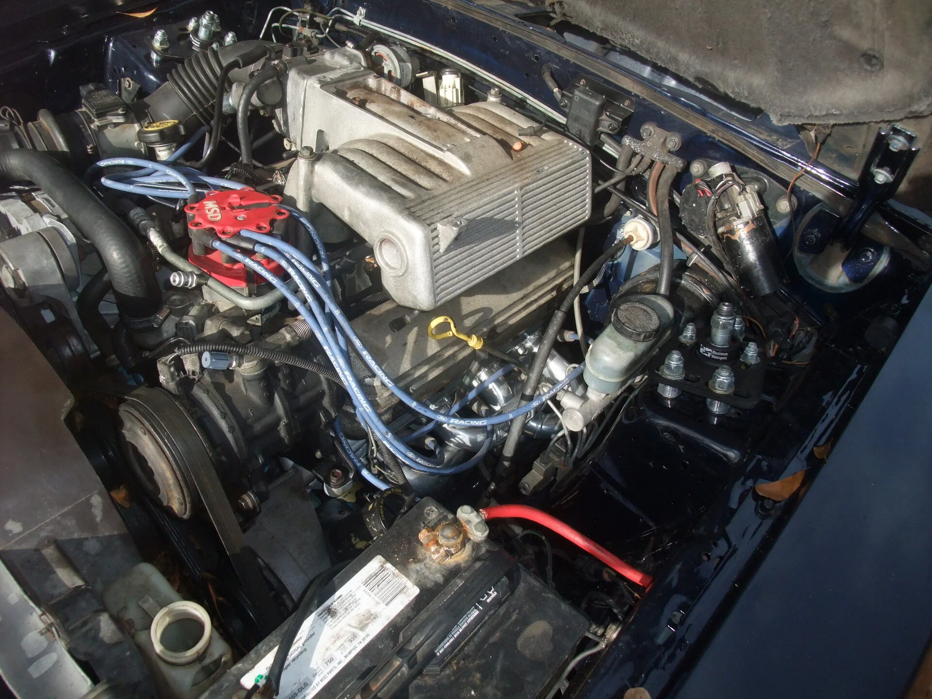

Just a couple pics to prove its back together....runs good, have not driven hard yet....no idea how much faster it feels.
Oh BTW those ppl. who think the BBK equal length headers are hard to work with are crazy. They went on easy, plug access is fine, and the wires work just great w/o need of heat sleeves or anything...
