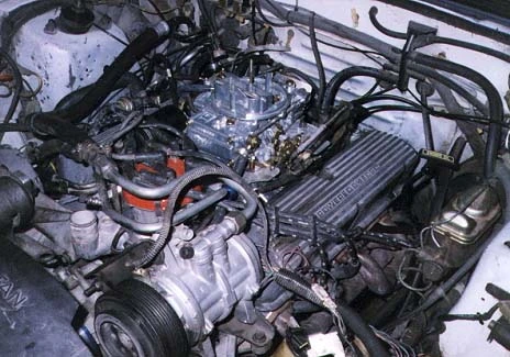

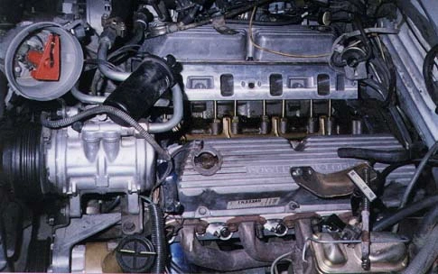

a couple pics..
cap should be big.. same as the FI

is there supposed to be an adapter that goes between the cap and dizzy>? if there is then the dizzy i have is wrong because there is no place on the dizzy to screw a adapter to ,,, i just called another parts place and they are gonna order a new one and see what happens

Someone may have already answered this, but for a stock style dist, the cap is a two piece affair.
There is a base that fits the alum dist housing. Two spring clips on the base hold it. It has two more spring clips on it, and they hold the cap on top of it. The cap where the plug wires go is much larger in diameter than the adapter base and dist housing.
Supposedly, an old style (points type) Ford cap will also fit. Probably without the adapter, but the wire terminals will be female, socket type, vice the male style for the Duraspark wires. I think MSD and the aftermarket distributors may use small caps with the Duraspark terminals. There may be a combination of small cap that will fit the base w/o the adapter and work.

Are you sure that dizzy is from an 85GT because I never had problems getting a cap for my car and I'm totally certain it was the original dizzy. The 2 piece you are talking about really isnt an adapter. There is the aluminum base, and then a plastic shroud that screws onto the aluminum, and unless its broken, it shouldnt ever be removed. Then the cap goes on top of that using those 2 latches on the side.Maybe you should post pics of your dizzy so we can see it. Maybe you should try ordering caps for earlier and later models to compare. Maybe its not an 85 dizzy.
It sounds to me like you need the Ford adapter. Someone described it pretty well in an earlier post. It goes between the cap and the distributer. The purpose of it is to keep down spark scatter at higher RPM's. If you can't find one new(I've had trouble finding one), look in the bone yards. They were put on pretty much every V8 between 79-95. Not just mustangs, they're on Crown Vic's, Lincoln's, Cougar's, T-Bird's, etc...
