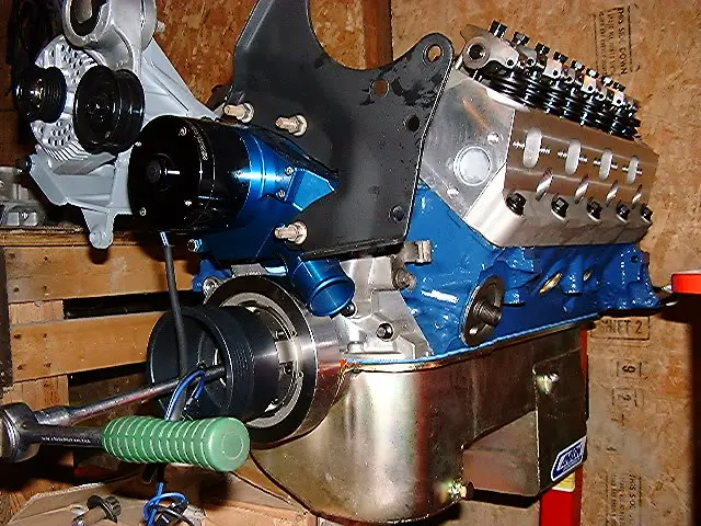

the thing i dont like about that waterpump and the moroso one is the whole backing plate design, I am more fond of the external motor. You had any problems with leaks?
I have used the Aerospace units, they flow more then a CSI and pull less amps....
However if you need to use the water pump as a pulley like Joe pictured above Meziere is the only way to go!
I do not need a unit with a idler pulley on it. Whats the best? This will be on a weekend/ice day cruiser. But during the summer I want to drive it to work pretty often.

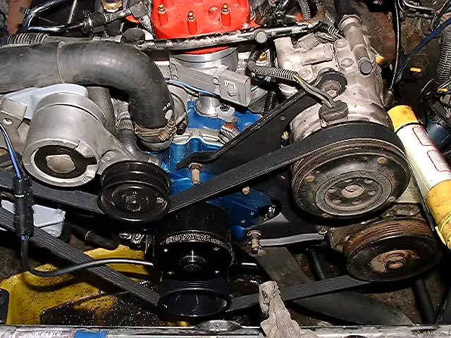

i have a mezier 300 series. you can still retain A/C and P/S as well. you just have to grind the A/C bracket a little so it clears the top of the pump.

i'd say it drives fine. if it is slipping at all, i can't hear it. you know that high pitched squeeling, its not there.
also forgot to say that other than being able to run A/C and PS, it has provisions for the t-stat bypass and heater line. another reason why i chose this style.
