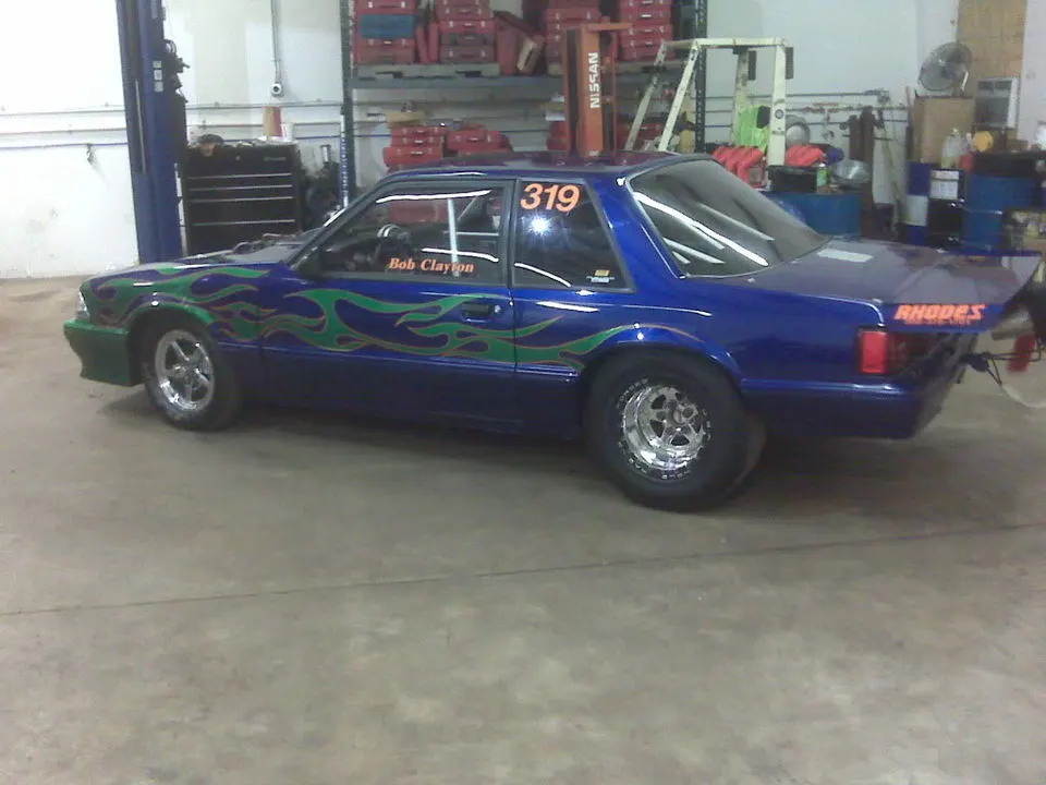

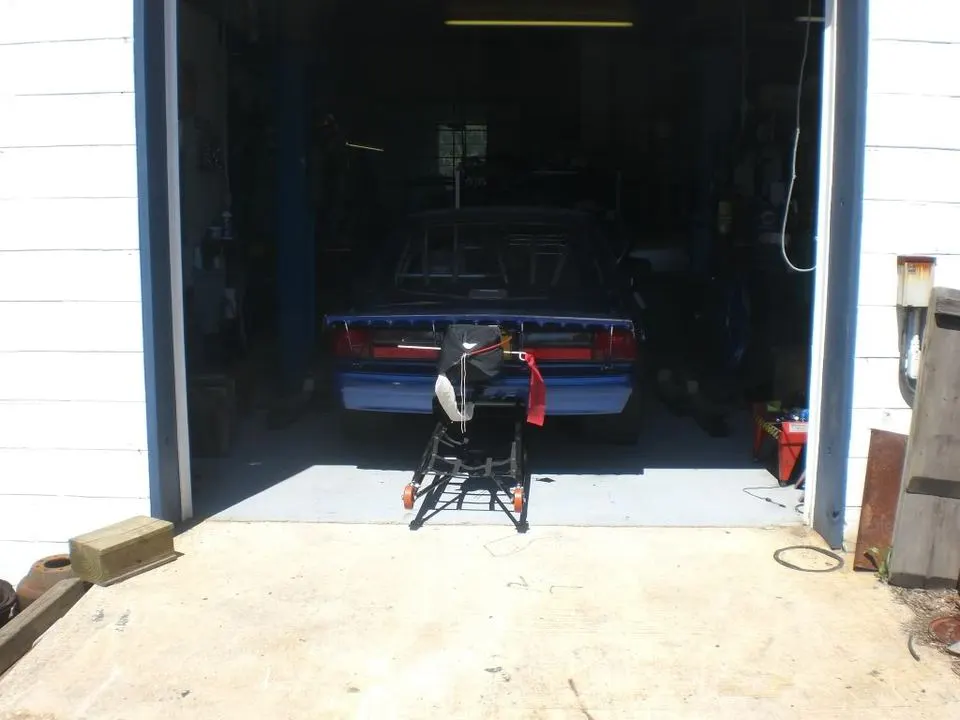

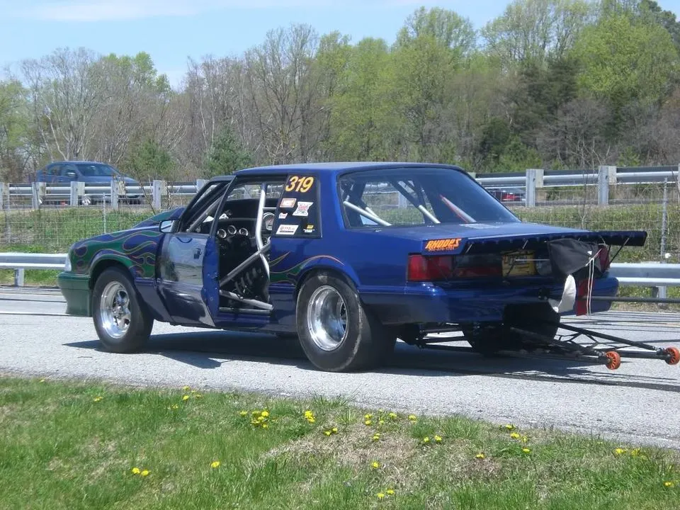

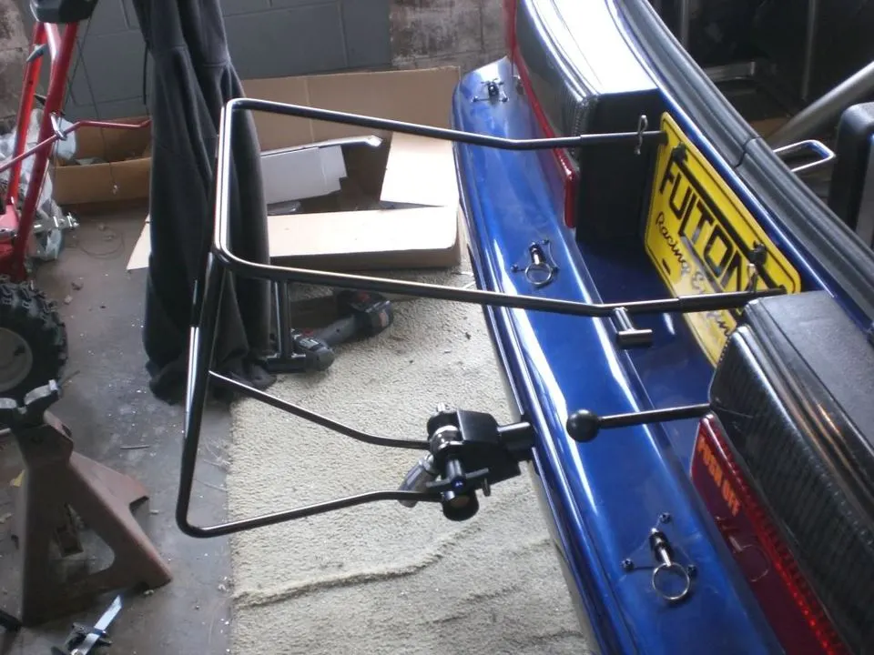

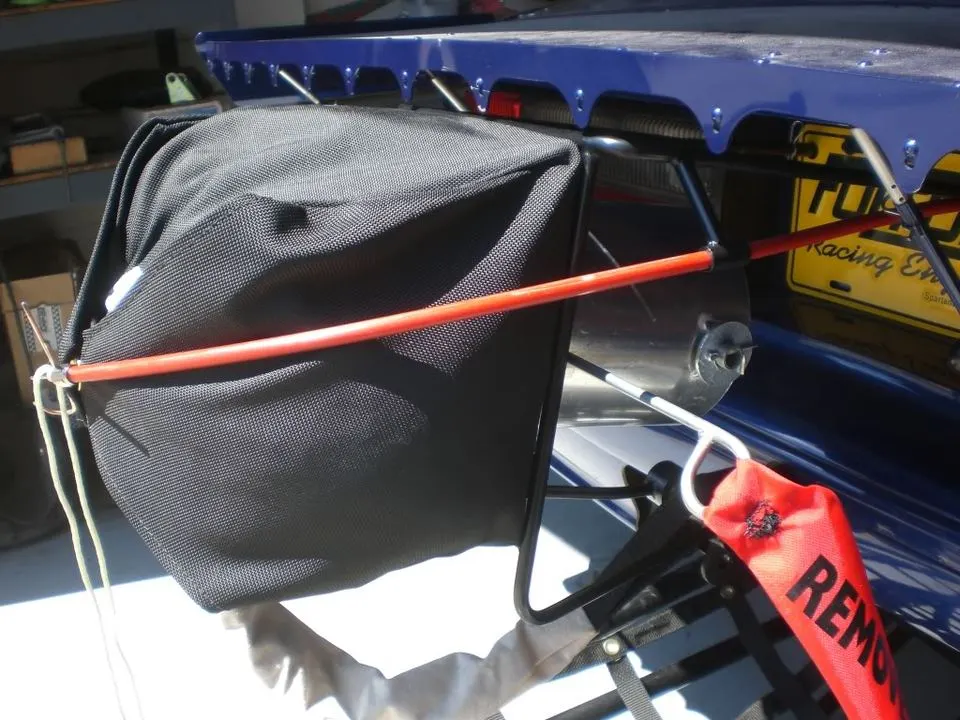

here is a few pictures of how rhodes mounted the stroud shute on the race car

thats cool. Is that the stroud mounting bracket as well? I have seen some that where less involved, didn't seem to have the bracing between the top of the chute mount and the body at the license plate area. just had the disconnect thru the lower bumper cover. I also like the placement of the battery disconntect, I have to put that on this winter as well and was trying to figure out where to run it thru the body with a parachute mount.

no that mount was custom made by rhodes custom auto in del. they are about 3 hours from the cj pony parts.
