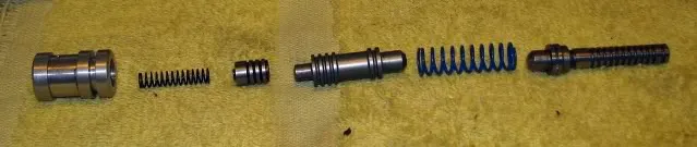

I had everything laid out to shim and add spacers for the TV valve assy
Turns out someone in my house decided to move the valve assy by mistake
Here is a pic does this look right?
I was told by baumann for the best adjustment they have seen is (2) 0.55 spacers and one 0,032" shim. Where do the shims and spacers go?

You have those laid out just the way they go, but that is not where the spacers go.
What you are showing a picture of there is the (throttle (tv) valve).
The spacers go in (TV limit valve) a totally different valve.

Thanks for the clarification Wade I got it now. I feel like an idiot now
Thanks for the help much appreciated
