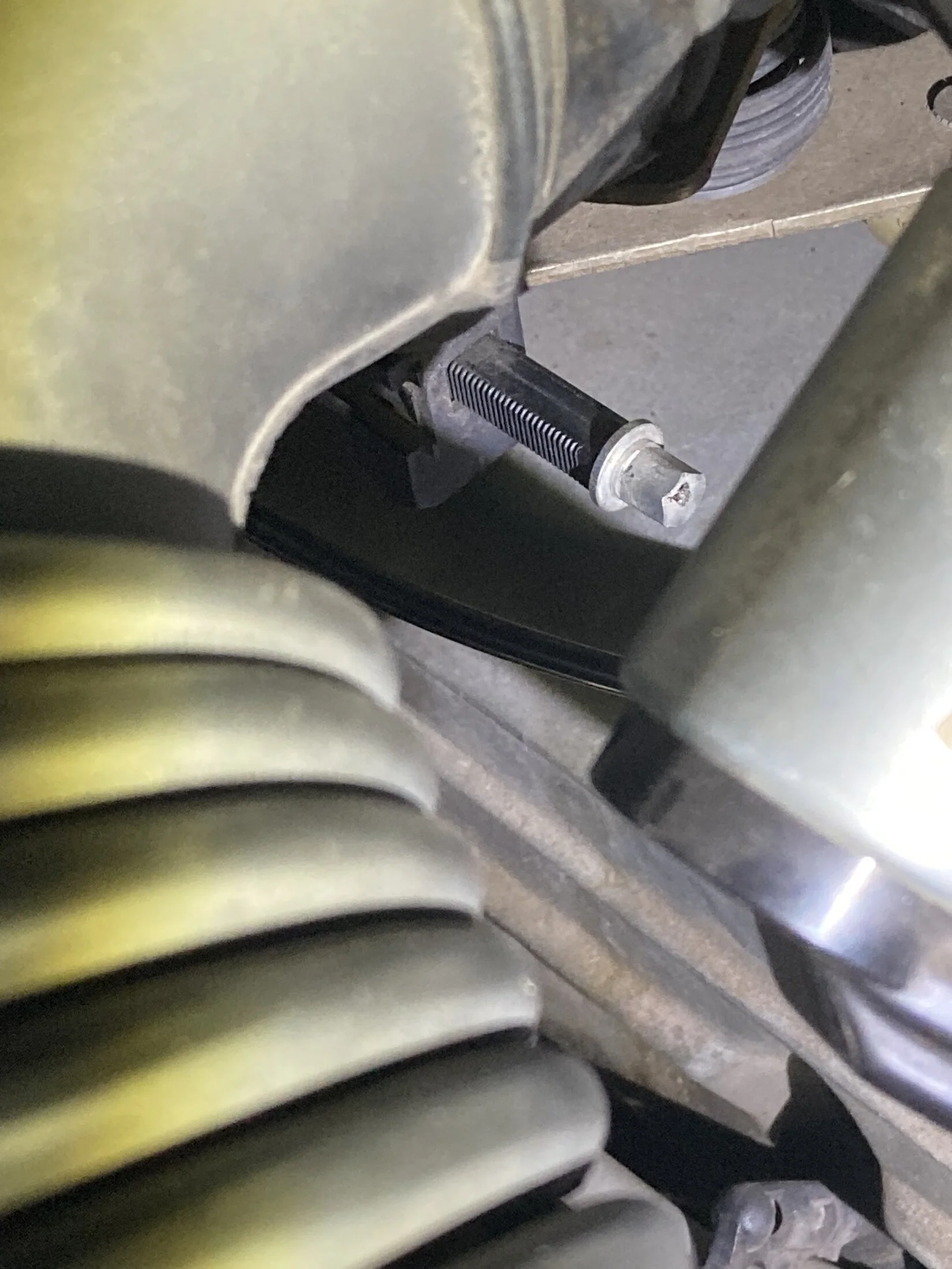

Put a Fairbanks shift kit in and now it's shifting from 1st to 3rd. You can get into 2nd by doing the AOD shuffle... I hope it's just something in the valvebody. The shifts were so light on stock form that I couldn't exactly tell if it was skipping but I don't think so. I've got a reman valvebody coming to eliminate the valvebody as the issue. Wish me luck :eek:
Check to see that you set the TV cable properly?
Hello, I haven’t messed with the tv cable. This is how it currently stands
