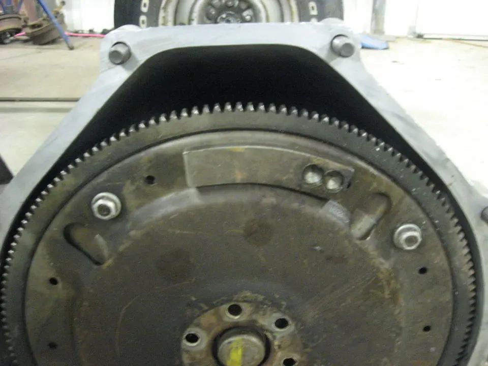

i picked up the AOD today, question is, how will i know which flexplate i have?? I looked for a number, but could not find one, attached is a picture.

Grab a pen and put a dot on one particular tooth.
1,2,3,4,5,6,7......
23,24,25,26....
81,82,83,84...........
j/k
Ring-gear diameter will obviously be greater for the 164-tooth flexplate. Need to know which size your particular AOD requires, as well as what you have presently. Armed with that info, go shopping if what you have isn't what you've got.

I'm not so much worried about the TOOTH....rather the imbalance. if i remember correctly there's a 28 oz and a ?54 oz imbalance.
Oh! You're still running the 289/302/Windsor; right?
Then you want the 28 oz. Balance counterweight tracks the engine, not the transmission. Early 289's/302's/351's(both Windsor and Cleveland) wore 28 oz imbalance flexplates/flywheels. Not until the "5.0" did the 302 switch to a 50 oz weight.

maybe i didn't explain it well, I know that i need the 28 oz imbalance from a 69' up 351. either that or I'll see if my flexplate from my c4 will work or not.
what I'm trying to figure out (since there's no number stamped on the flexplate) if i've GOT a 50oz or a 28 oz??
didn't know if there were differences in appearance betwix the two (other than the obvious size difference) guess I'll be able to tell that when i take the one out of my c4!

THe one in the picture looks like a 50oz weight, but it just looks that way to me, I could be wrong...any "good" machine shop can spin it and tell you what weight it is, AND if they are a "good" machine shop, can rebalance it to 28oz. But, you need to see what they charge, compared to a new flex plate. THe new flex plate may be cheaper.
