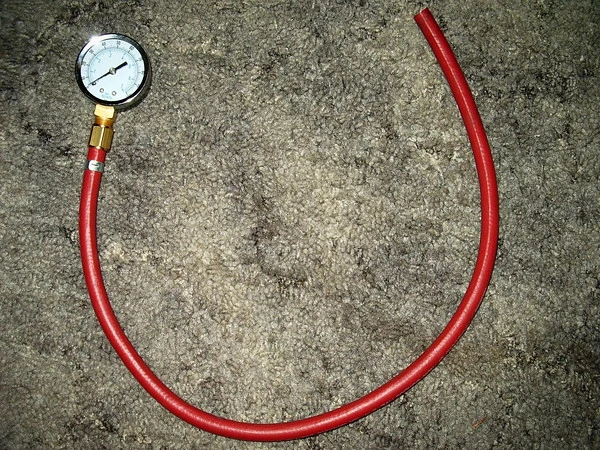

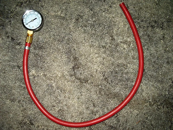

All you need is one of these...

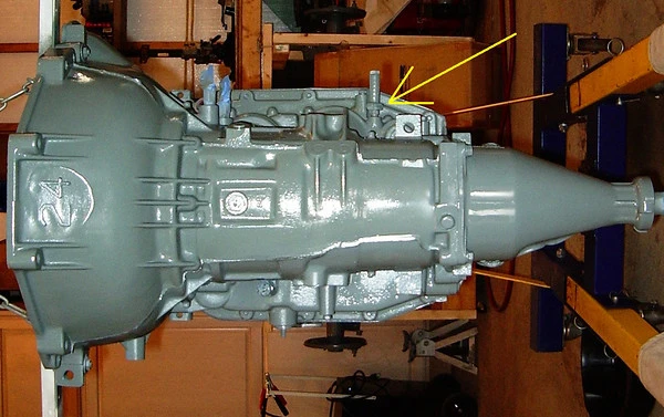

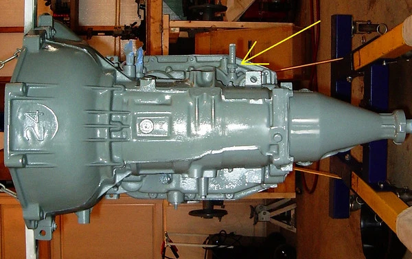

And plug it in here... (yellow arrow)

when you say plug it in,you mean like screw it in with a thread or just pop in in, or on top of that tube...???
There should be a threaded plug in the hole... take it out and get a fitting that has the same threads as the plug and has a nipple on the other end that the hose can slide over. Use a clamp to hold the hose on and put the gauge on the other end and use a clamp there too.
