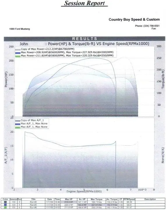

The reason I am asking is I had my 89 Notch run on a dyno trailer last Sat and this is what is did but the numbers just do not seem right to me and it was the first time I ever had a car on a dyno. Also what is the best way to shift an AOD on a dyno. Thanks

It's a little low, but probably not by a lot. Stock automatice equipped Fox bodies dyno about 185-195rwhp. I would guess you should be putting down somewhere in the 215-220rwhp range. You've got some decent breathing mods there, but trying to choke all of them through the stock E7TE heads is what's killing you. You'd probably pick up an easy 40-50rwhp at this point going to a set of one of the more popular aluminum castings.
What kind of dnyo they used? Dynojets and Mustang dyno's will differ....sometimes by quite a bit. The Mustang Dyno will usually register the lower of the two.
Your 'vert has almost all the same exact mods as mine. And that seems about right for a stock fox. prepping it before the dyno may have helped your numbers (oil change, seafoam, fuel injector cleaner, etc.)
