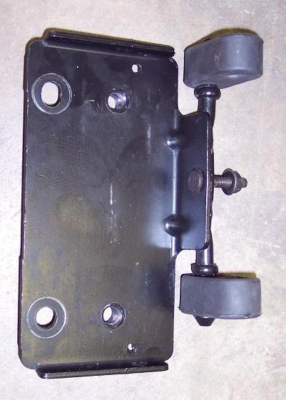

If you can get the exhaust plate from the T5 it will make the alignment a lot easier. The T5 sits forward a little more than the AODE. The T5 exhaust plate has two sets of holes where the AODE plate has only 1. If you use the right plate with the right transmission, everything should line up perfectly. If you use the AODE plate with a T5 you might need to turn the crossmember around. I ended up drilling out a second set of holes in my AODE plate and that worked pretty well.
Here's a picture of the T5 Plate:
As you can see, everyone seems to have different results with the same mod and the same parts.

Yea that is weird. I didn't have to modify that plate at all. I just used the same aode crossmember and it all lined up perfect. It must have been my luck day....lol
