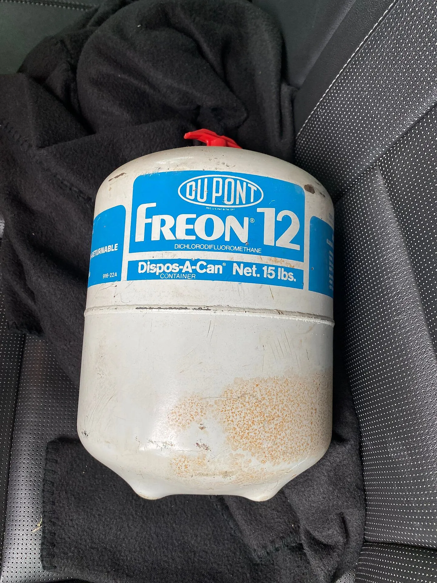

Someone grabbed it. Hopefully someone here. That price is par for the course for R12. $40/can or so.
I have this plus some cans...so i'm good for a while. :)

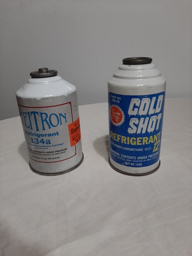

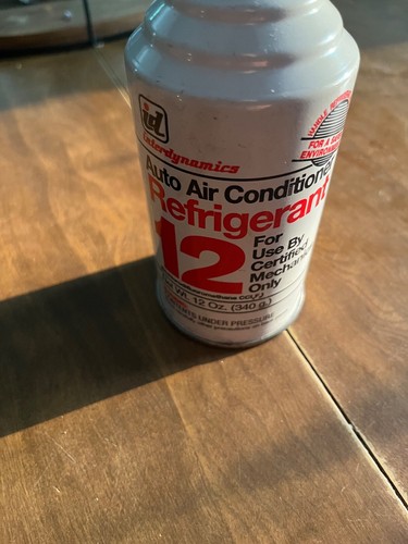

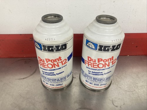

I threw a bid on that (not winning) just to see if that thing gets pulled before the 9-day auction is up. I think it will.
BIN seems to be the best way to get them.
A few years back, sellers were asking for copies of the license. Then they started asking for a waiver saying you were buying the cans to hand to a tech. Last few years its been a free-for-all and no license or waiver. Probably why they are pulling auctions.
