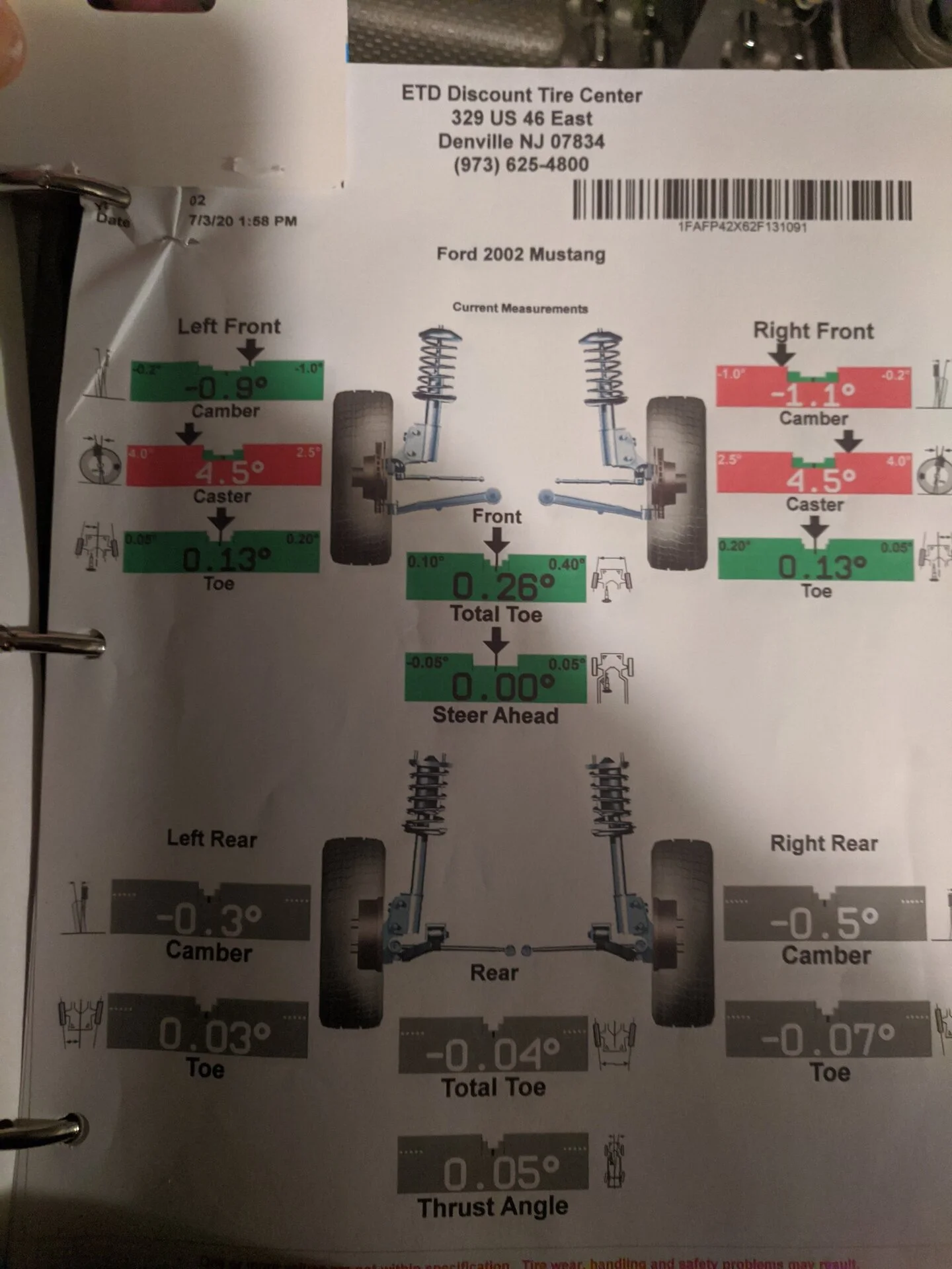

I did MM C/C plates on my 2002 and had my shop go for a higher (more positive) Caster setting of +4.5. I have seen others who have gone far higher than that, but I figured going just out of spec would be a good first shot. I think on the next alignment I'd go up to 5 or 5.5, my shop was happy to oblige. It shows red on the sheet because it is out of Ford spec. I felt like the steering was more stable with the added Caster and turns in nicely.
I stayed pretty tame in Camber at -1. Also, my car is stock height for now.
