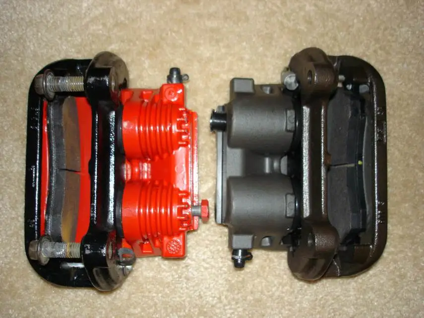

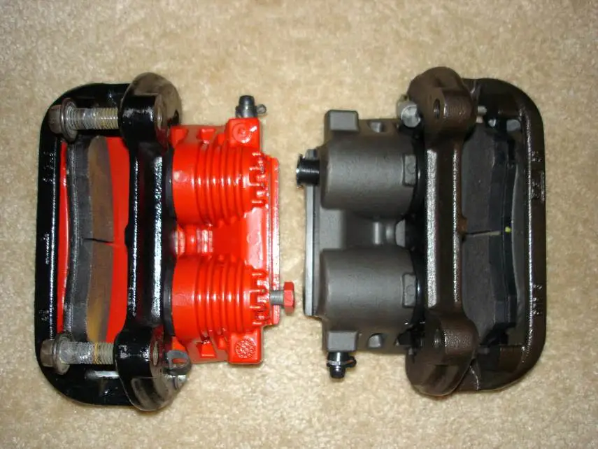

Here's the difference visually. The red painted caliper is a 94-98 Cobra caliper, and the black caliper is a Mach 1 caliper
You can see the physically difference around the pistons (thicker support on the 40mm caliper) and the difference in size in the actual pistons
The measuring caliper is set to the 40mm piston, and placed over the 38mm piston for comparison
