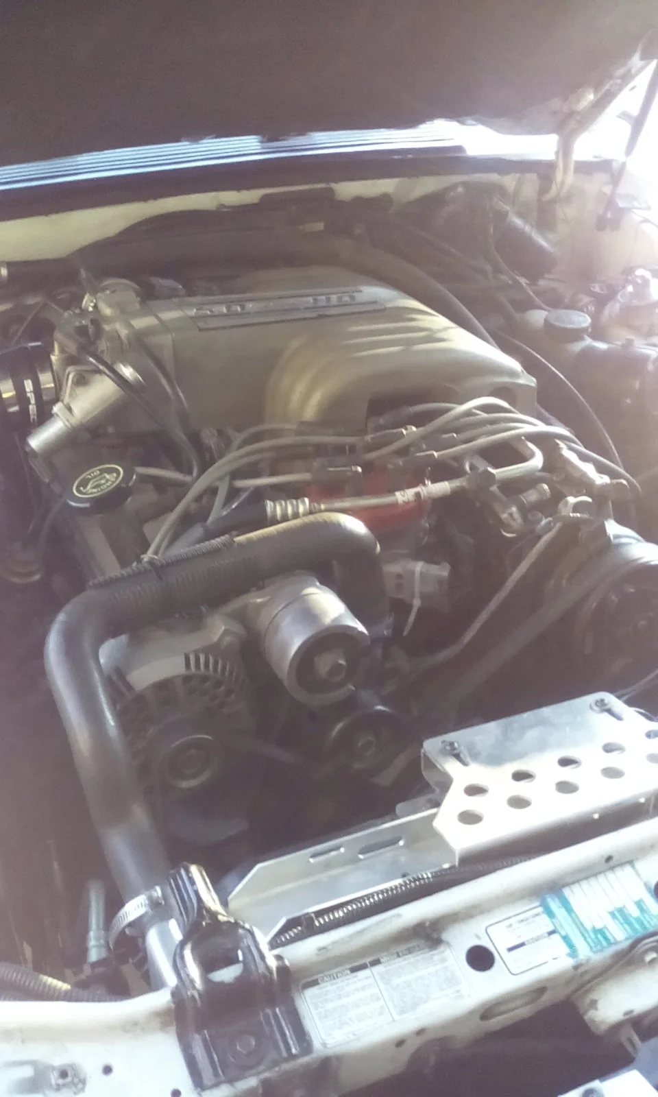

Please do your stang a favor,toss the 2 g . the 3 g upgrade is one of the simplest , I got one from pic a part ( 18.50) it had a duralst gold decal on it.also got pigtail. Lasted past 8 years then I replaced diode trio,that was three years ago.
