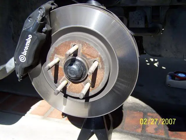

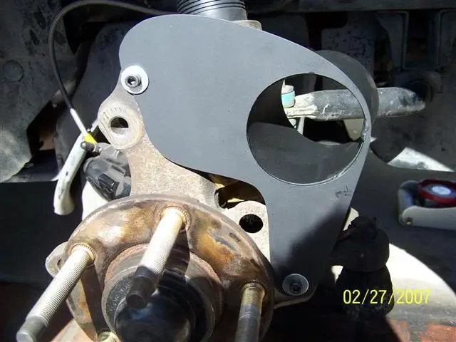

Night and day difference like some else had already said. Granted my GT brakes were worn, but after swapping on the Mach 1 calipers up front, Cobra setup in the rear, oem lines, Duralast Gold CMAX pads, oem rotors and new fluid. The car will launch you if your not wearing a seat belt I swear to god.
I love this setup.
this setup works too
