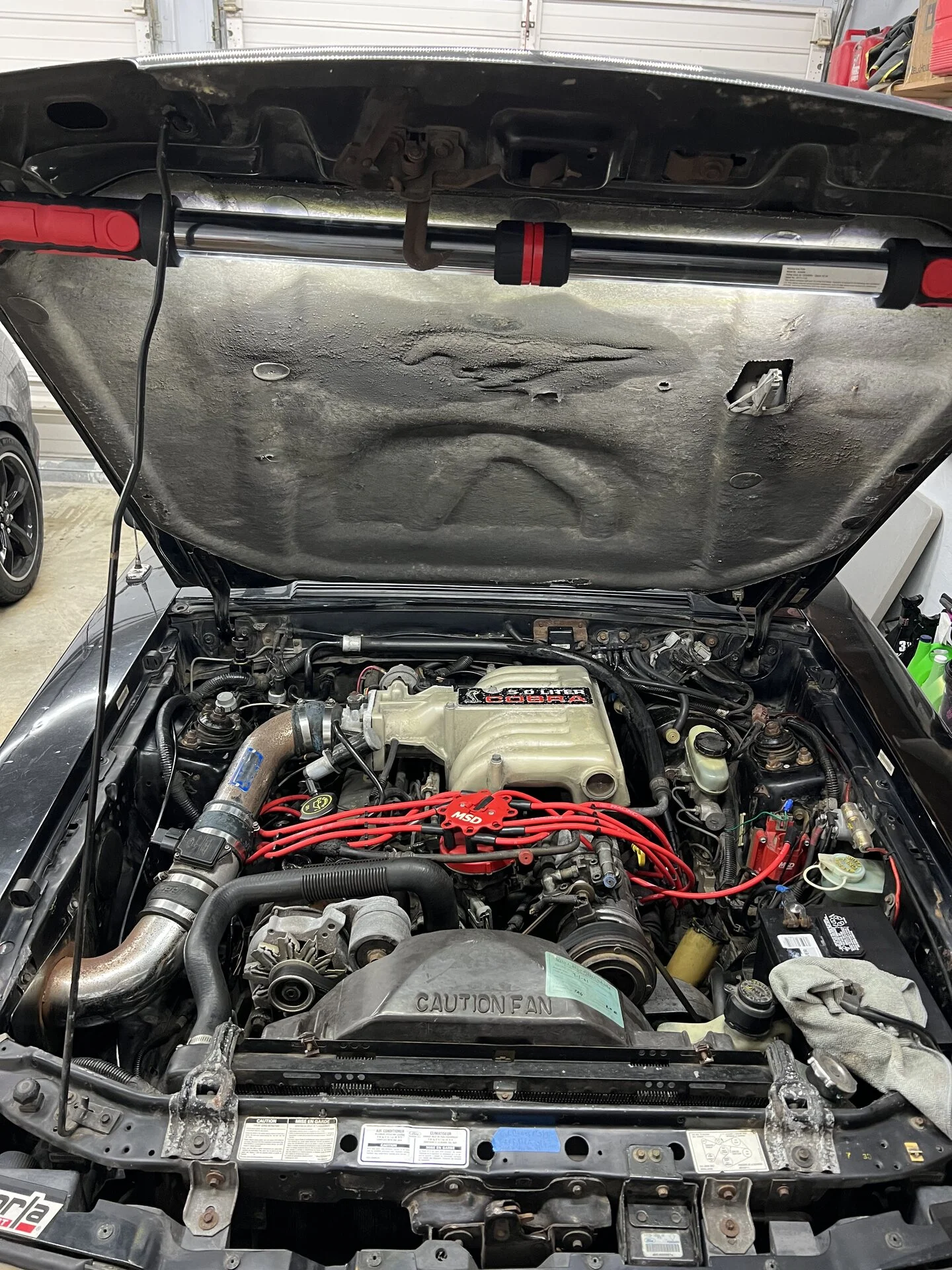

The bbk cold air intake that came on my car is rusted so I’m looking to get a new intake tube. I love the look of the open air intakes but I understand people say they can lower your engines performance because of the hotter air being sucked in. Is this true and is it anything major or noticeable? This is my current setup and this is the intake Id like to get photoshopped. Any info would be much appreciated thanks.

That link you posted is NOT a 'cold air intake', think about it, what would be better? Sucking air from outside the engine compartment or sucking air from inside the engine compartment?
I'm a cheap guy, I would take those tubes on the car and have them powder coated or paint them.
Reactions: 7991LXnSHO
Yes, it is true that an open air intake will hurt power/performance. You may not see it on a dyno with the hood open, but driving on the street will kill power and performance. A rough figure is 3-7% loss in power depending on filter size/location and the output of the engine it is going on.
Ideally, a plastic or composite inlet is preferable to a metal one as the heat soak is mitigated quite a bit.
I guess the answer depends on what you are trying to do. Most want the large element for added power. As said above it will likely hurt power overall as when driving as it will suck in the hot air that just came through the rad. Now the part where I said depends. If you are just cruising, don't care if you make more power it may help your fuel economy as the hot air will cause the PCM to lean out the mixture which will reduce power but if cruising increase fuel economy to some extent.

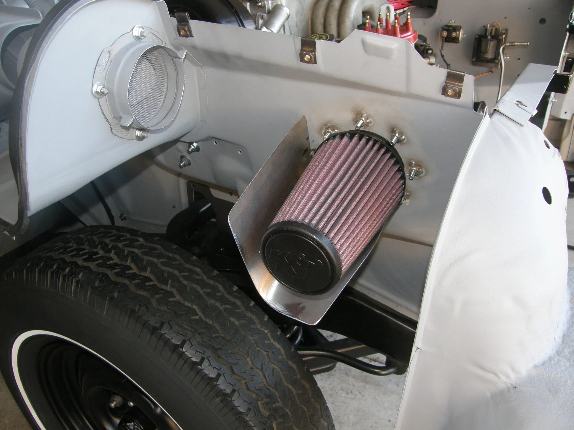

Wow, $250 for a CAI! It's just piping, couplers and an air filter. I made one for my '54. A 3" 90* pipe for $40 off Ebay plus another $35 for a K&N filter. The rest is factory '93 Mustang. Works great and doesn't break the bank.
