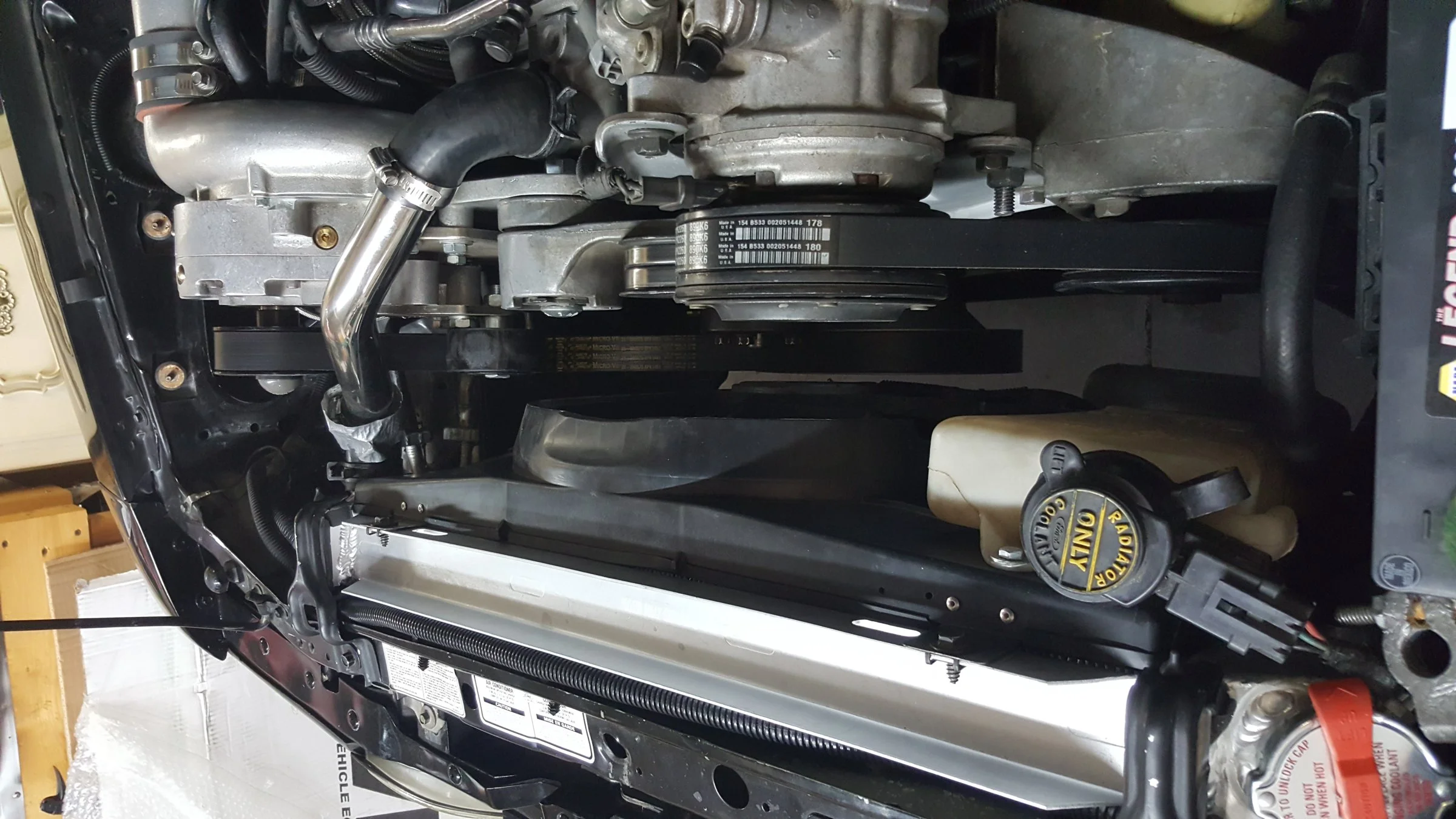

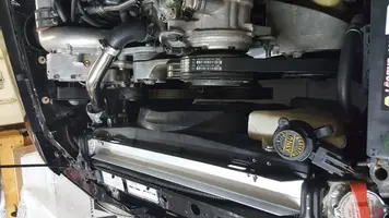

I've borrowed a Mishimoto from a friend as my stocker needed replacement worked well in the 100 degree weather while I used it. I ultimately went with sve and it was pretty much the same thing. Set up is 306, eddy heads, tfs cam, ported cobra, v3 si 15 psi
It's out of a early 2000s Volvo s60 I believe controlled by a dcc fan controller. Works really well keeps temps between 187-196 during summer. My car started to overheat at idle when I went with 8 inch crank pulley and stock mechanical fan.

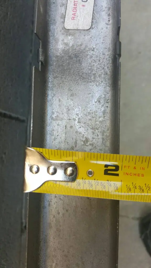

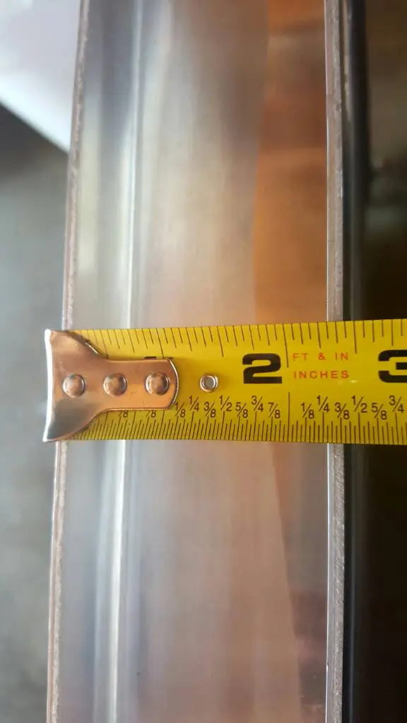

I run an S-trim (standard install,nothing special) and used to have a brass 3 row radiator and the factory fan.
I just bought an American Eagle 2 row radiator and it's too thick because the S-trim's tensioner gets in the way when trying to hang both the factory fan shroud and when I try to mock up the contour dual fan kit I have (with the contour one of the fans hits the belt).
Some notes: My old brass radiator's thickness measured exactly at 2".
This American Eagle unit measures out to 2"3/8' but their website says its 2.1" thick...anyways, its still an issue.
Radiator Dimensions:
Total: 19.25" tall (with cap) x 29.25" wide
Core: 16.75" tall x 24.5" wide x 2.13" thick
Inlet: 1.25" passenger side
Outlet: 1.5" driver side
Tanks: 2.75" thick
Tubes: 1" thick
Yes, the factory fan was notched at the bottom where it meets the crank pulley with the old radiator and perhaps I need to complete that notch all the way around.
What should I do? Move the wiring harnesses behind the rad support in order to pull the radiator closer to the support frame? Buy a thinner radiator? The Champion 2-row measures out to 1.75" thick, while the 3 row is apparently thicker than my American Eagle unit.
A few things at my disposal are:
Griffin Dominator Rad (was too big).
Modine 3 row brass replacement radiator that is in my SVO currently (I can always play the old swaparoo here)
The old leaky 3 row brass radiator that has been in this car from the 1990's.
Mark VIII and Contour (v6) fans.
Any help would be appreciated! Thanks in Advance.

The old brass radiator....<br />
<br />
<br />
<br />
The American Eagle unit...<br />
<br />
<br />
<br />

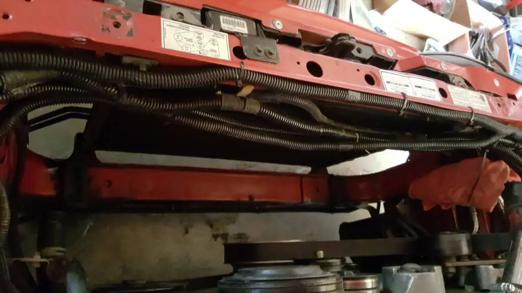

Bunch of wiring behind the radiator...<br />
<br />
<br />
<br />
Sent from my SM-N920P using Tapatalk

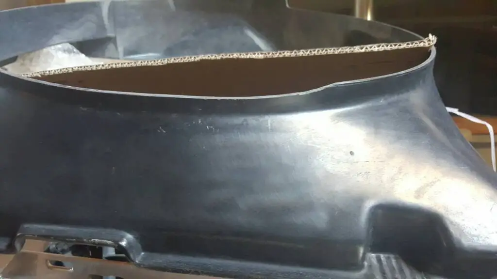

The oem shroud was notched years ago to clear the crank pulley. I think I need to continue this notch all the way around. Will this negatively affect the cooling benefits brought on by the shroud itself?<br />
<br />
<br />
<br />
