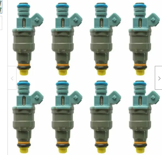

OE Ford 24#ers are Blue with gray bodies. I think Mark 8's and 460's came with these with an F2 part number on them.
There is also a ford racing version that is the same shade of blue but with black bodies.
I forget who made these injectors. Bosch or Denso. I've also seen aftermarket injectors (Accel for instance) that don't follow the typical color convention and are completely black.

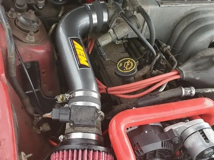

I’ve found this AEM one that no one has really mentioned the review of after install. I’d say it looks cooler than stock box and if it didn’t hurt anything, I may go with it.

So with the filter element in the engine bay you can experience fan wash (do a search) which causes fits for the MAF.

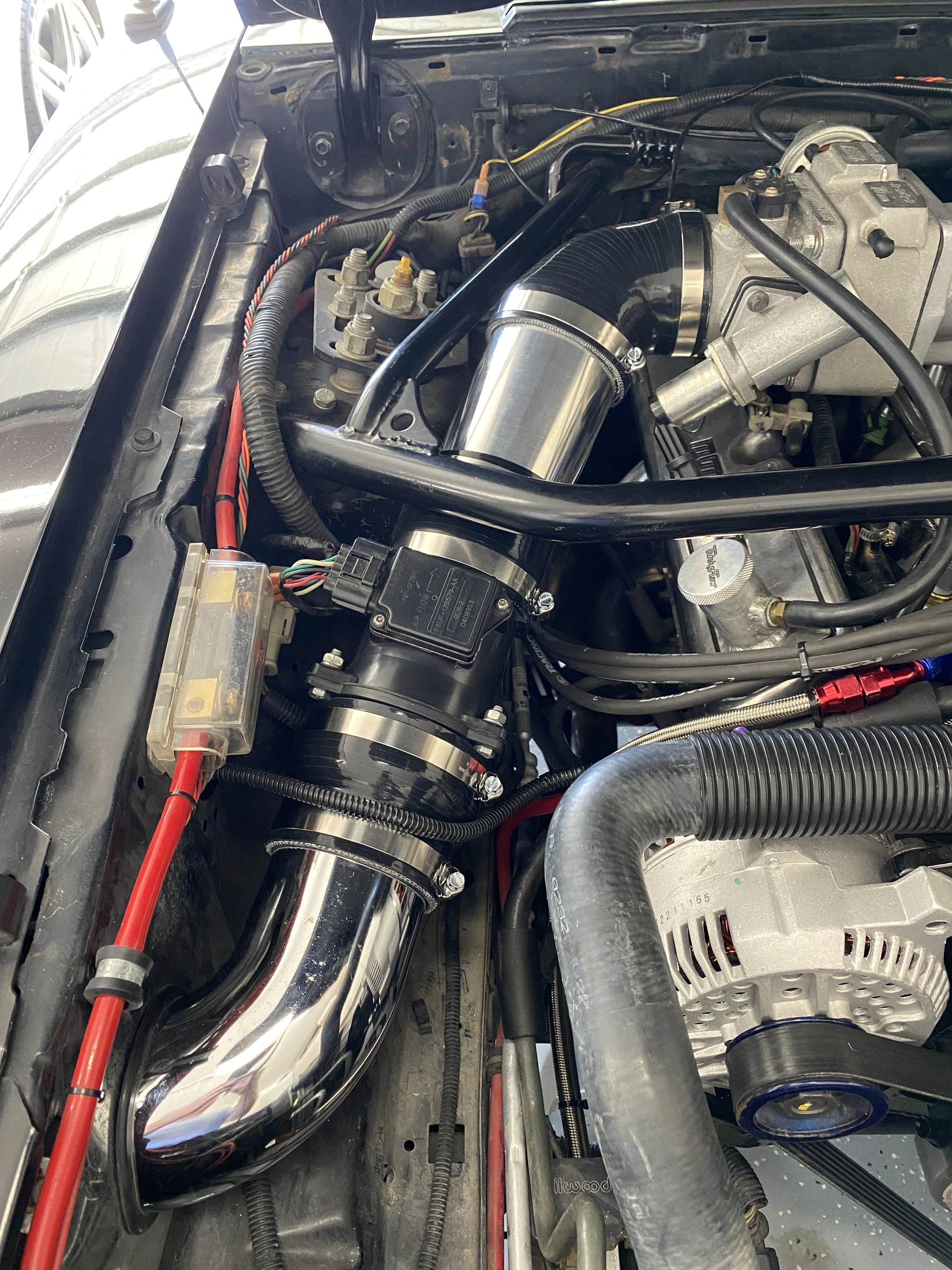

Here is my setup
Car it tuned and that is an 80mm MAF from a 2000 or 2001 GT.
Reactions: gkomo
That is a HOT air intake, fine if you're just try'n to look cool but with the MAF and filter together like that it's also know to cause issues with the MAF readings.
