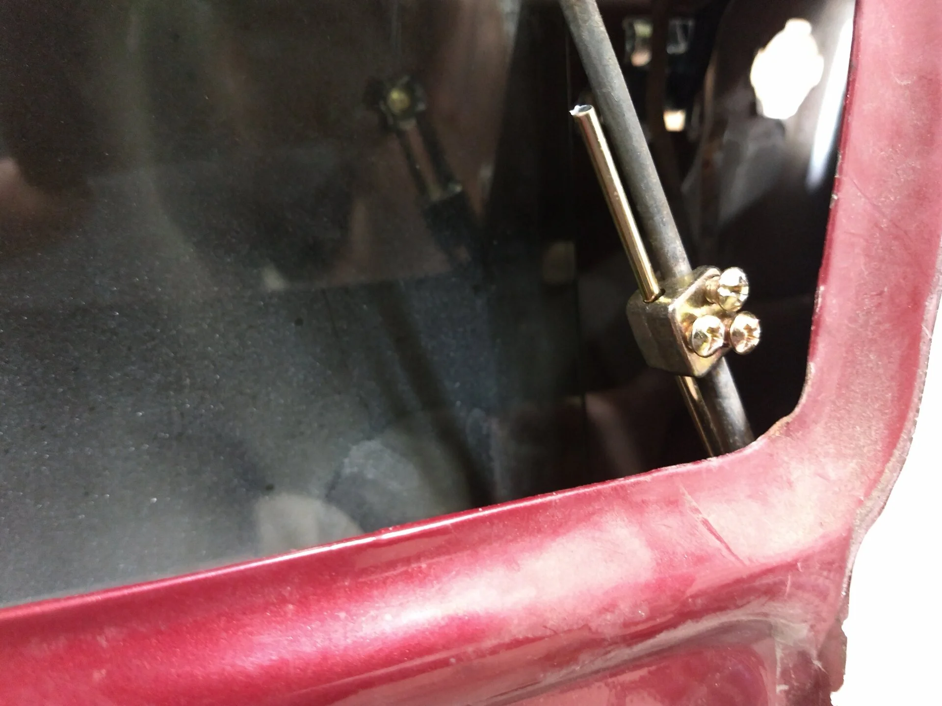

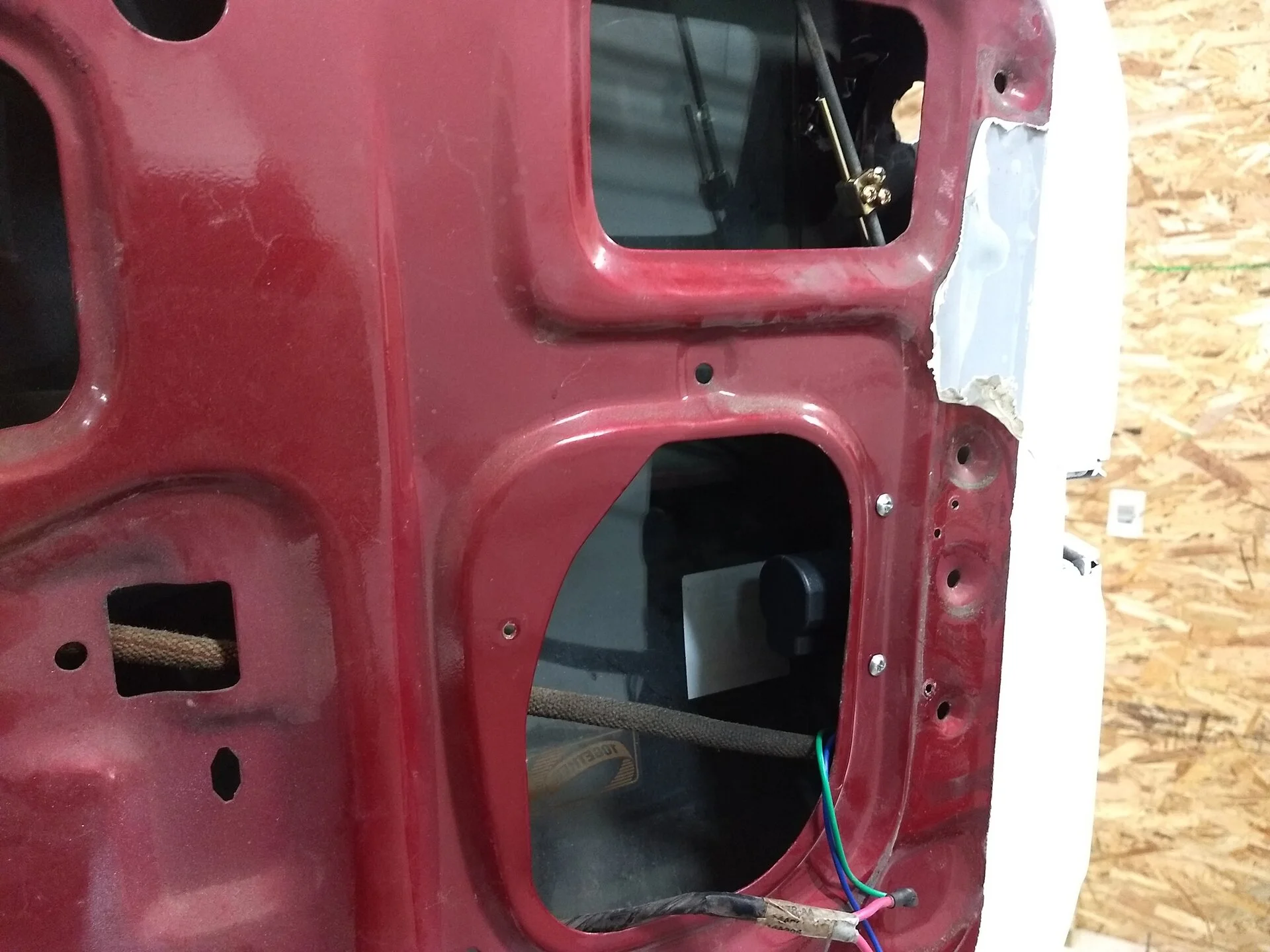

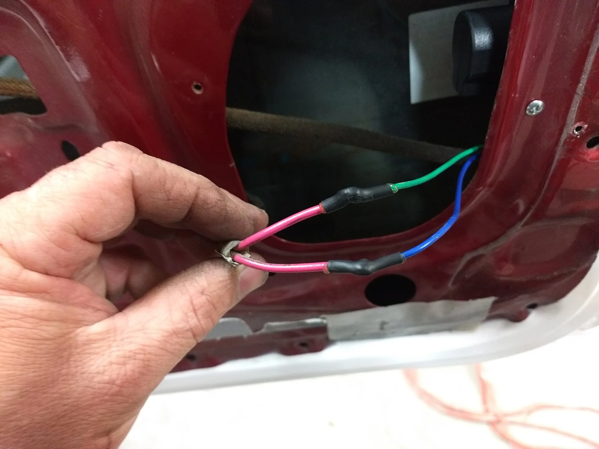

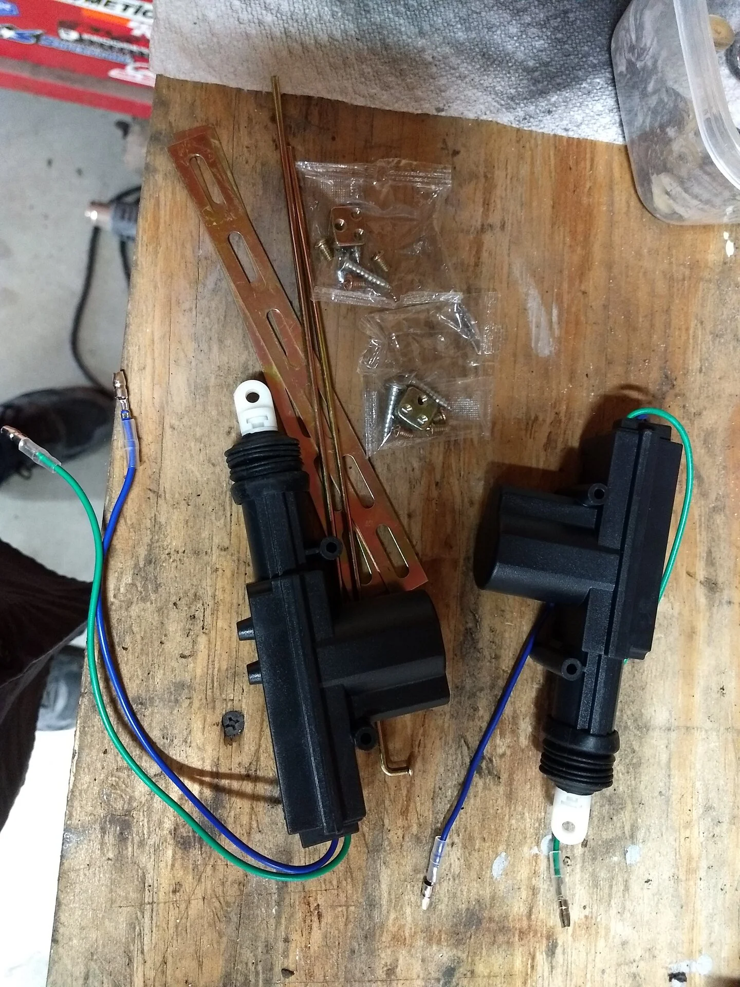

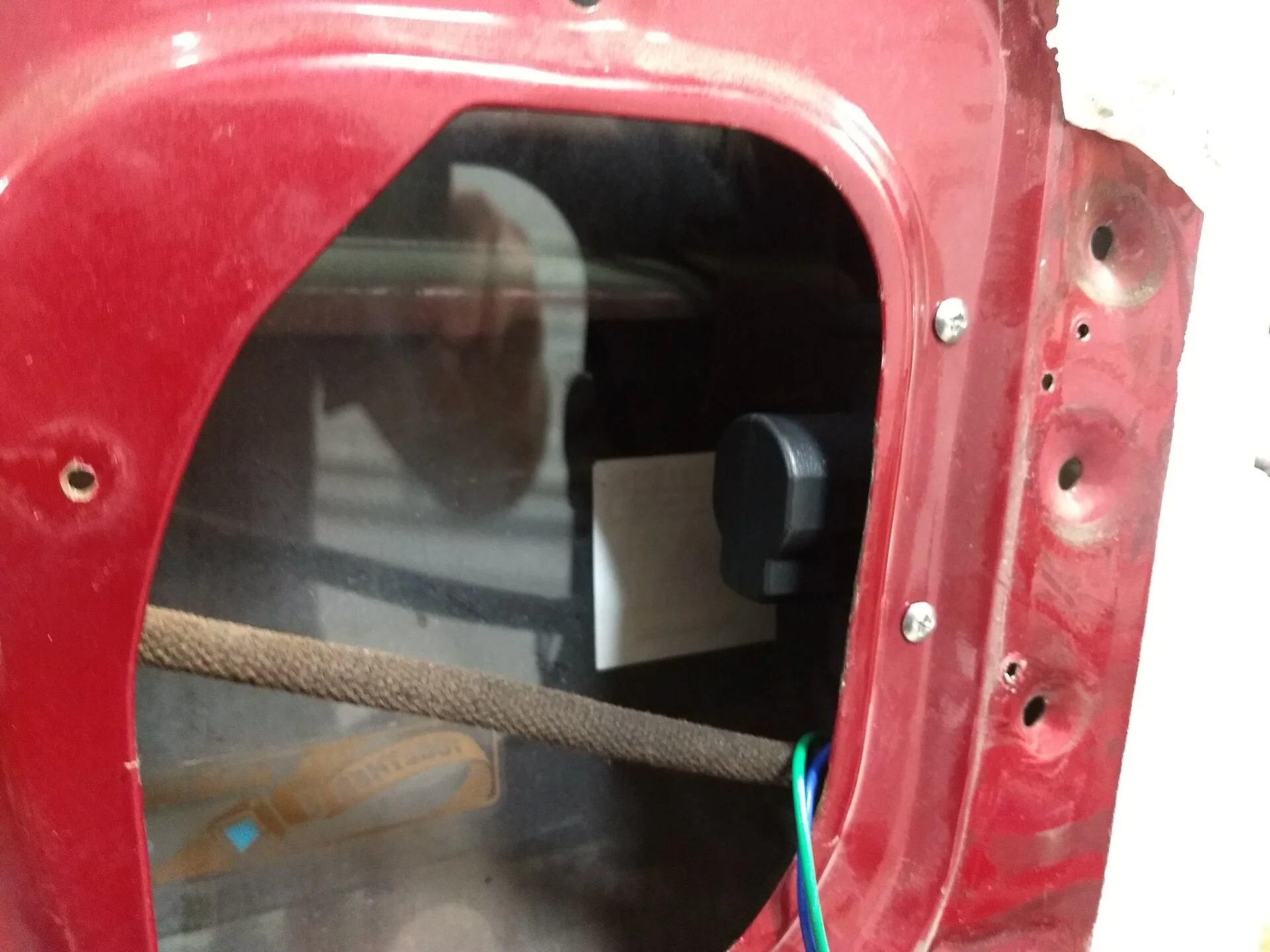

So tonight was all about getting the power locks to work. I read thru several threads and saw @jrichker had a solution using cheap universal door lock actuators. So after a little searching, I found a kit on Amazon for $10. jrichker did a very detailed write up, and fabricated some nice pieces to put these in almost like a factory installation. I however did none of that, I'm much too lazy, and decided to use the actuator rods and clamps in the kit and come up with an alternative method. No step by step write up from me, but here are some pics, I did ziptie the wires neatly after the pictures were taken.
They work like a charm, so for $10 I'm happy.
