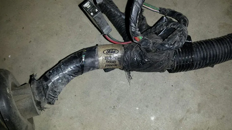

I'm trying to buy a '89 5.0 engine harness for my '88 GT and a guy has two for sale but they have different part numbers. I just want to make sure they're from 89 models before I buy one. But they have slightly different numbers.
17291982186_4d49e09b7f_c.webp Untitled by Sn8kebitten, on Flickr
This one looks like E9ZB-AD 12A581 P260H-8L (that last L could be a D)

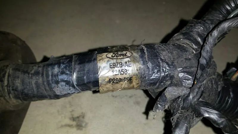

And this one
17317501901_f6bb4f7fba_c.webp Untitled by Sn8kebitten, on Flickr
Looks like
E9ZB-AE 12A581 P260H-9F
I would rather have the first one because the second will need some work done to it. So are they both from '89 models? I could only find one for sale ad with the part number of the second one and nothing on the first
The two harnesses shown are functionally the same.
The different dash number at the end indicates some small change that does not affect the functionality. These changes are for things like different original manufacturer, small design changes like harness wrapping material or method, or placement of wires inside the harness.
