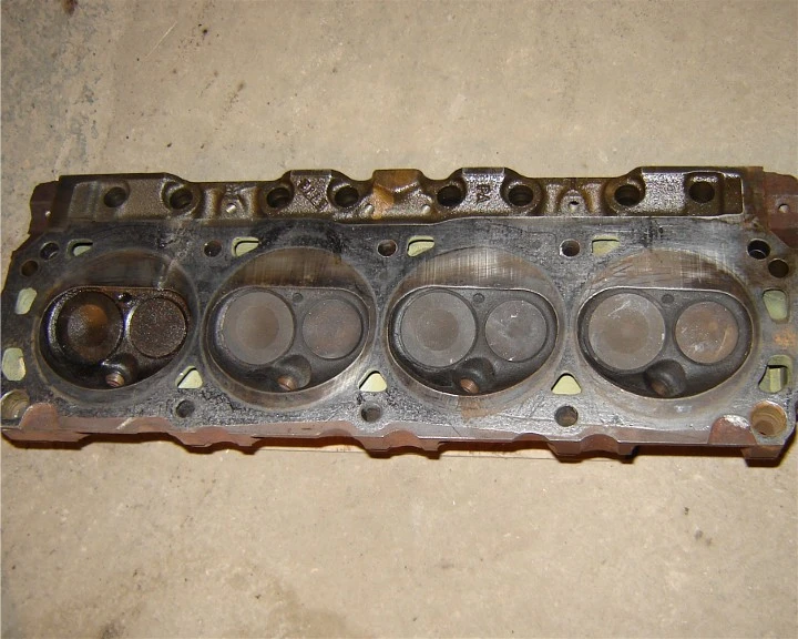

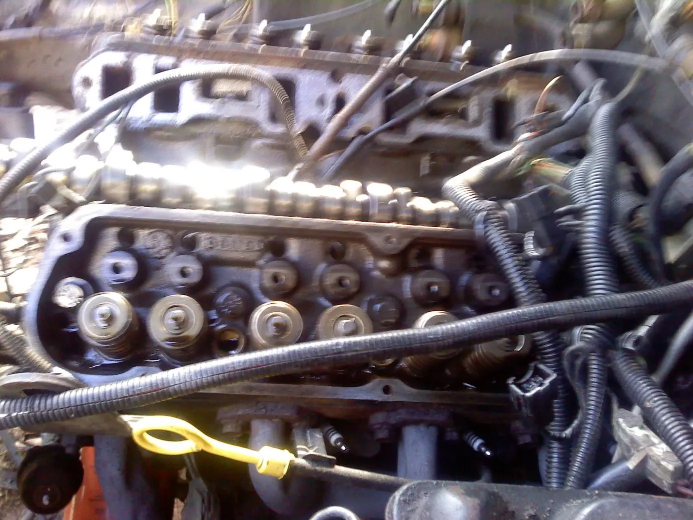

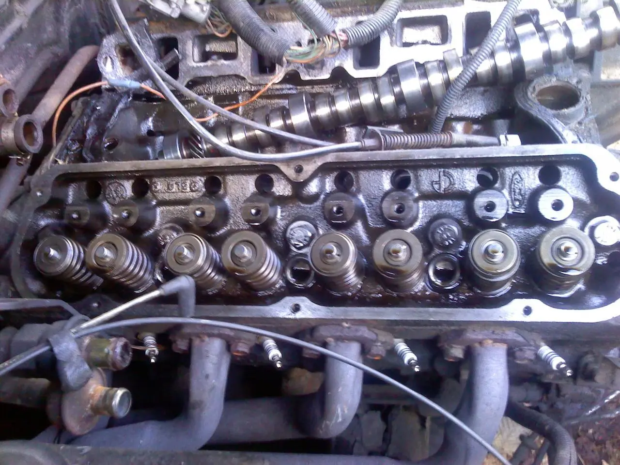

are these stock heads? and stock cam?
Take a pic of the heads and post it. I have seen those things inside and out. Make sure you get both the valve side and the rocker arm side.
Couldn't tell by looking at the cam .. sorry. Those numbers aren't even familiar. Did you try googling them? Where are the numbers located?
here is a pic of drivers and pass.
Well, yes they are stock heads....but it's still tough to see which.
They could be either E5's, E6's or E7's.
Do you have an inspection mirror? Look under the head where the pushrod guides are for a part number. The first two digits are what ou are looking for (E5, E6 or E7)
The p/n will be on the 2nd cylinder back on the driver's side and the 3rd back on the pass side..like here. It's 4 letters/numbers...the first 2 will tell the story
These say E7TE
