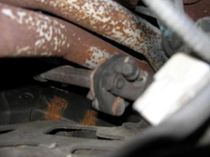

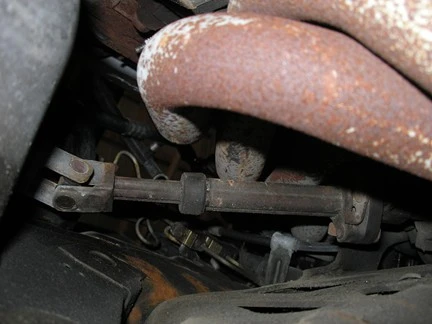

still no luck. I have a feeling I'm doing something wrong...The first picture shows the bolt I took out, the second is a slightly better picture of the shaft....I need to know if this is the right bolt or not...
Thanks guys
Looks like the right bolt. Pry apart the metal a little; there should be a split in the metal, which the bolt was holding shut.
Alright...looks like I just need to get on it a little more then...I've been breaking things lately so I've been a bit hesitant...Thanks for the assistance...I'll get it loose tomorrow
ok guys...starting to lose my mind.
first of all, that steering shaft does not want to budge. anyone ever had it seized on or something? I can't really get anything in there to pry it off either...
