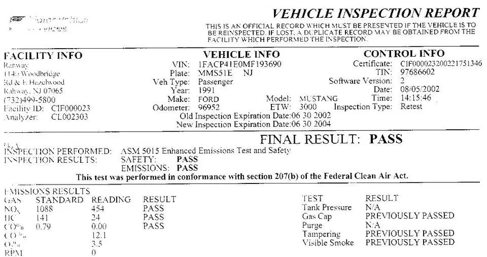

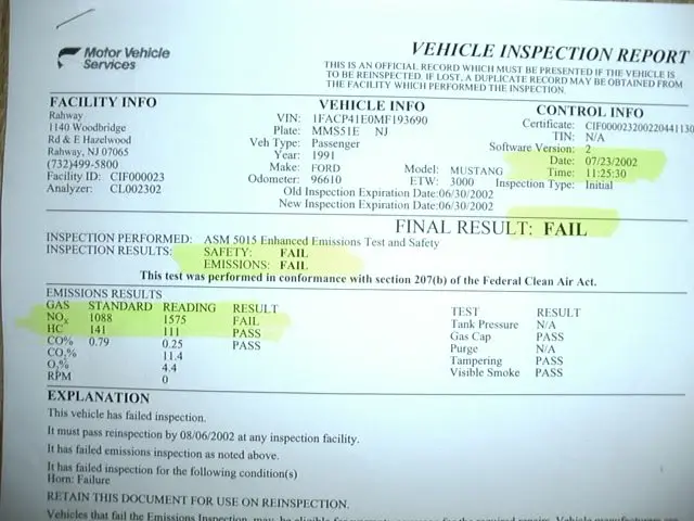

Into 1/4 tank of gas I poured 1gal of denaturated alcohol (avilable in any hardware store for about 12 bucks) and here are before and after results.

A few miles, basicly from the store to the inspection station and as soon as I was done I filled up with premium. I heard of guys dumping 5 gallons in and basicly running on that through inspection.
